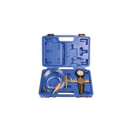

As a quick note, I changed out water pump last weekend, and used Pedro's recommendation of the Airlift coolant fill system. It really, really does work awesome. I would suggest to perhaps 'drain' the coolent, save it, then replace with the Airlift. There will be no bleeding necessary, and is very quick to do.

I found a bunch of "Airlift style" vacuum coolant fill systems under $80 on ebay.
I don't really understand how they work.
Do you attach a hose at the system low point to suck in the coolant and then apply vacuum at the coolant tank? Where is this low point?
From one video I saw it looks like you create a vacuum at the overflow tank and then let it suck fluid back into the system from the tank fitting.
Doesn't make sense that all bubbles get eliminated that way as its the same as just pouring in fluid from the tank ?
Can someone elaborate?

The tool uses a venturi system to create a vacuum and remove all the air from your cooling system (after you have drained it and closed it back up again). Once done, the gauge tells you if the system can maintain this vacuum (checks for leaks). You then disconnect from the compressor and put the fill tube in your bucket of coolant and the vacuum in the system sucks all the coolant back in. There is no air trapped if you have properly maintained vacuum conditions.
It's really quite impressive how well it works, and it completely eliminates the need to "burp" the system.
I have the actual Uview Airlift tool, not a knock-off, and can only speak for the results I obtained with this tool. I also have a decent air compressor (Dewalt 1.6hp, 15 gal tank rated for 200 psi, 5.0 CFM @ 90psi)
'99 black 986
This?
http://www.amazon.com/UView-550000-Airlift-Cooling-Checker/dp/B0002SRH5G

I just ordered this one for $72 shipped, all brass, probably comes from the same plant in China where all the others are made as well.
FJC 43610 Coolant Vacuum Kit

No rubber sleeve to seal it to the mouth of the coolant tank. You'll have to hold it in place to use it so you'll probably need an assistant to change the mode from the compressor to the coolant bucket. Doing a lengthy vacuum test may get hard on the arms.
I predict you'll be sorry you cheaped out.
