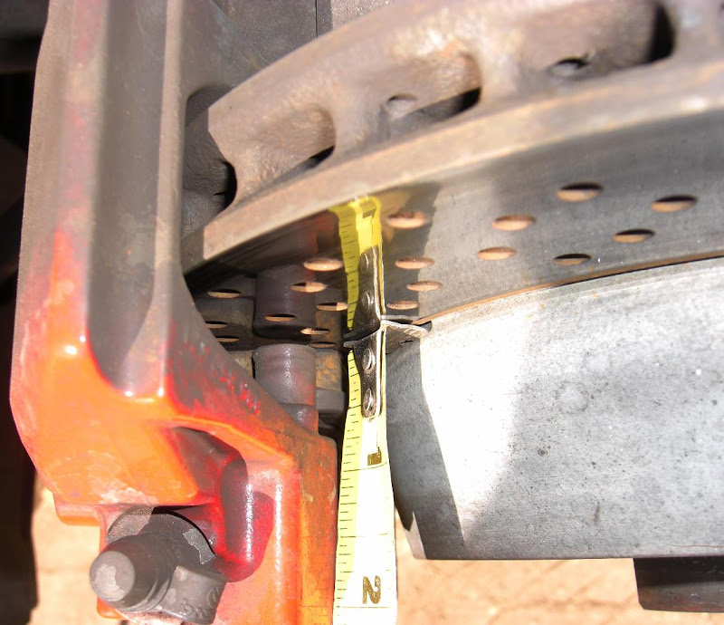

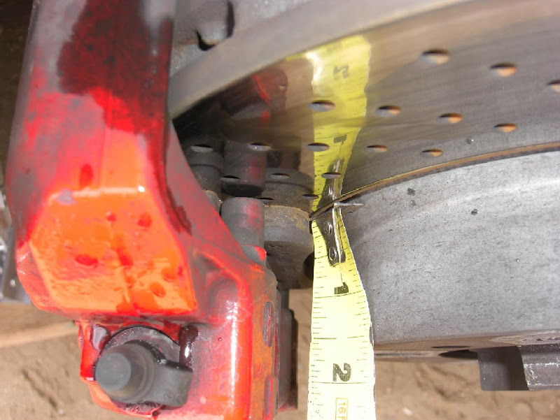

Its a little hard to tell but my 2001 S has slightly beveled holes in the rotors.
The bevel will be less visible as it gets worn off.
Fronts
Rears

One goal of the slight beveling is to reduce the likelihood (or maybe delay) the formation of cracks that emanate from the drilled holes. It is surprising that the OEM rotors didn't have this feature.
