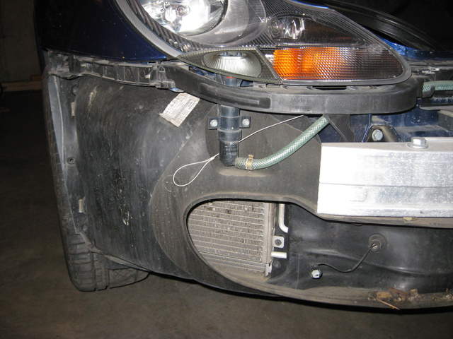

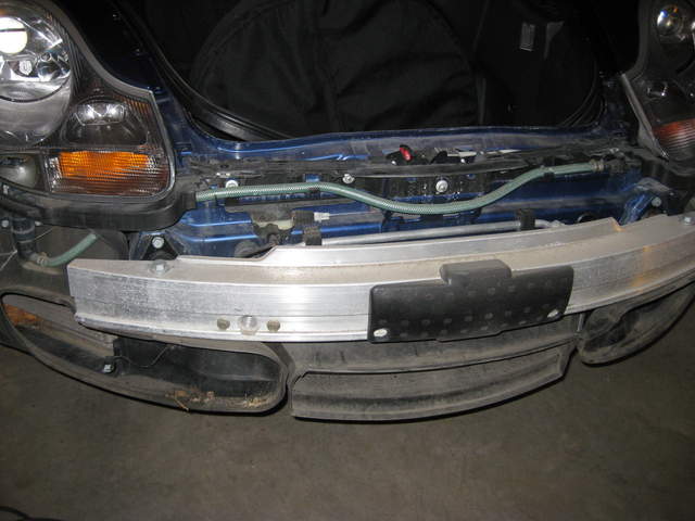

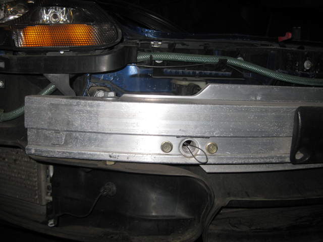

Here's what it looks like on a 2004. I had the bumper cover off to clean the rad's so,... take some pic's.
top view, look below right headlight and below headlight washer.
right front headlight view
re-routed wire

Very nice photos. They are much appreciated. Once I get the frunk open, this would be a great project.
