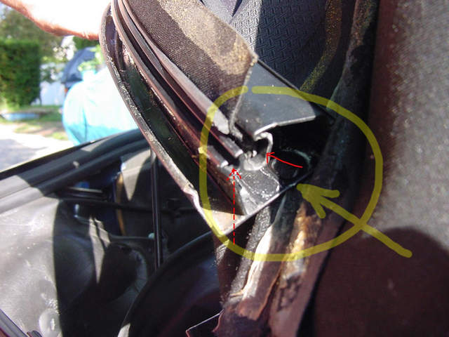

Old 10-04-2013, 03:42 PM   #5
Usercpy
ilikeching's Avatar
Join Date: Aug 2012
Posts: 205
maybe its this (yellow circle)

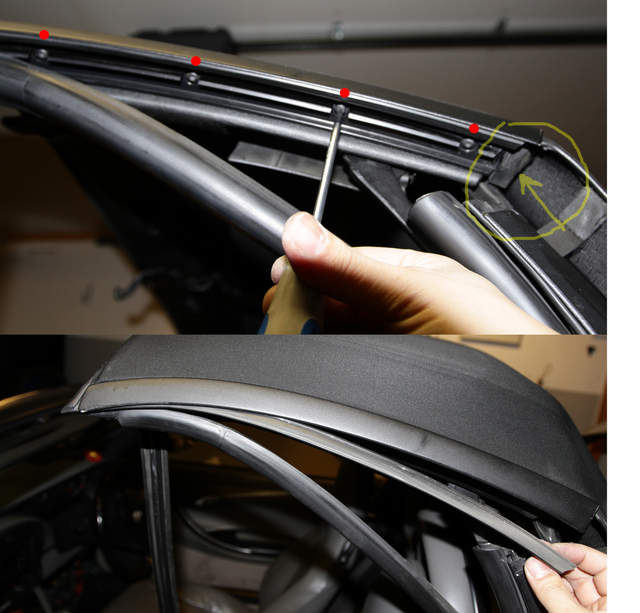

Old 10-04-2013, 03:47 PM   #6
Usercpy
ilikeching's Avatar
Join Date: Aug 2012
Posts: 205
or this end plugs for the rails...(yellow circle)

Old 10-04-2013, 05:55 PM   #7
Join Date: Dec 2009
Location: Toronto, Canada
Posts: 190
I agree with pic in post 5

Old 10-06-2013, 10:46 AM   #9
Join Date: Aug 2010
Location: Severna Park, MD
Posts: 98
No 5 is right
Just replaced my top Friday and that is where the originals were located.
