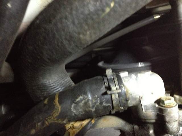

just replaced my water pump last june'13, it was making some grinding noise and some dried gunk on the underneath hoses , replaced the thermostat also and the hoses,
it's pretty easy,
check out my posted video on youtube on bad grinding water pump type in "986 water pump"
