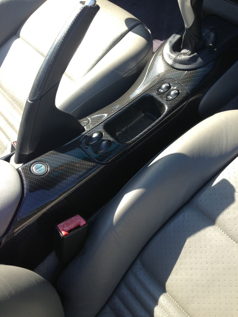

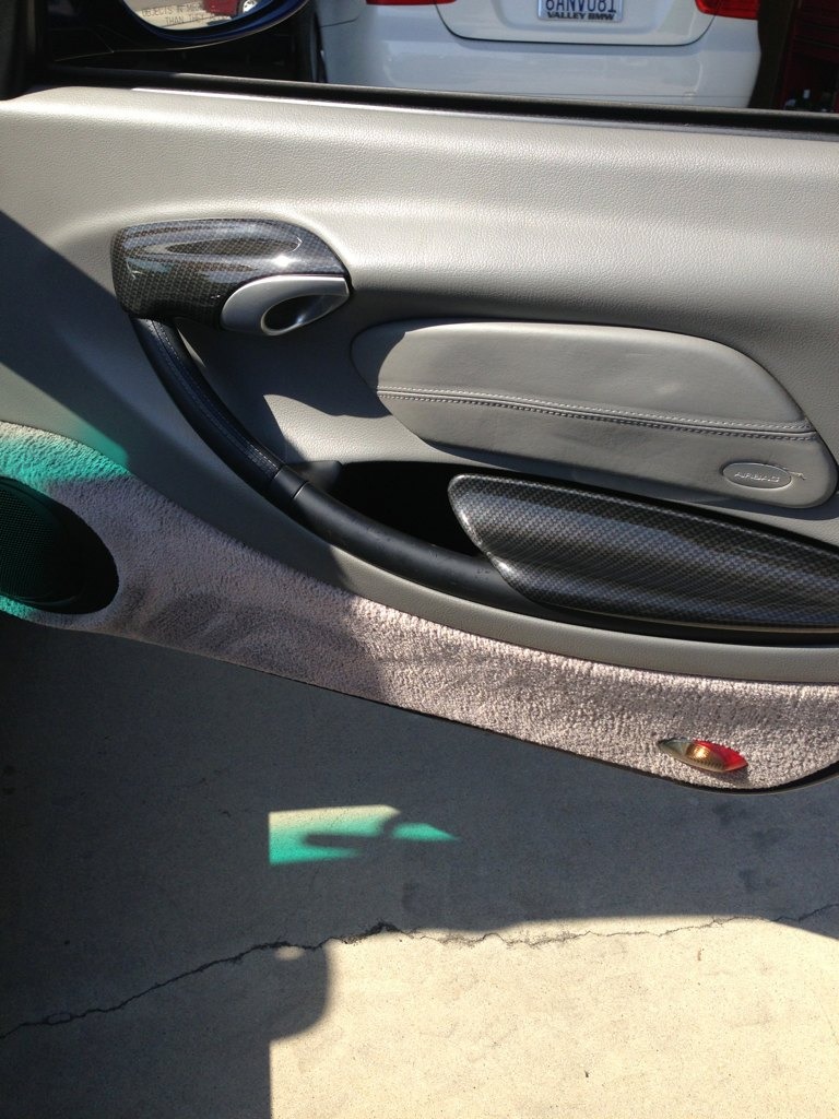

Originally Posted by hancock1701 View Post
Thank you all for the info. It seems like plasti dip is the easiest/least work route, but many other forums say that plasti dip doesnt last very long. I think I'm gonna leather wrap the two arm rests. Still undecided about the main console. Has anybody tried to leather wrap the center console?
I got mine hydro dipped along with the armrests, door handles and door sills. Total cost $350Name:  ImageUploadedByTapatalk1377887071.621186.jpg
Size:  163.1 KBName:  ImageUploadedByTapatalk1377887084.619717.jpg
