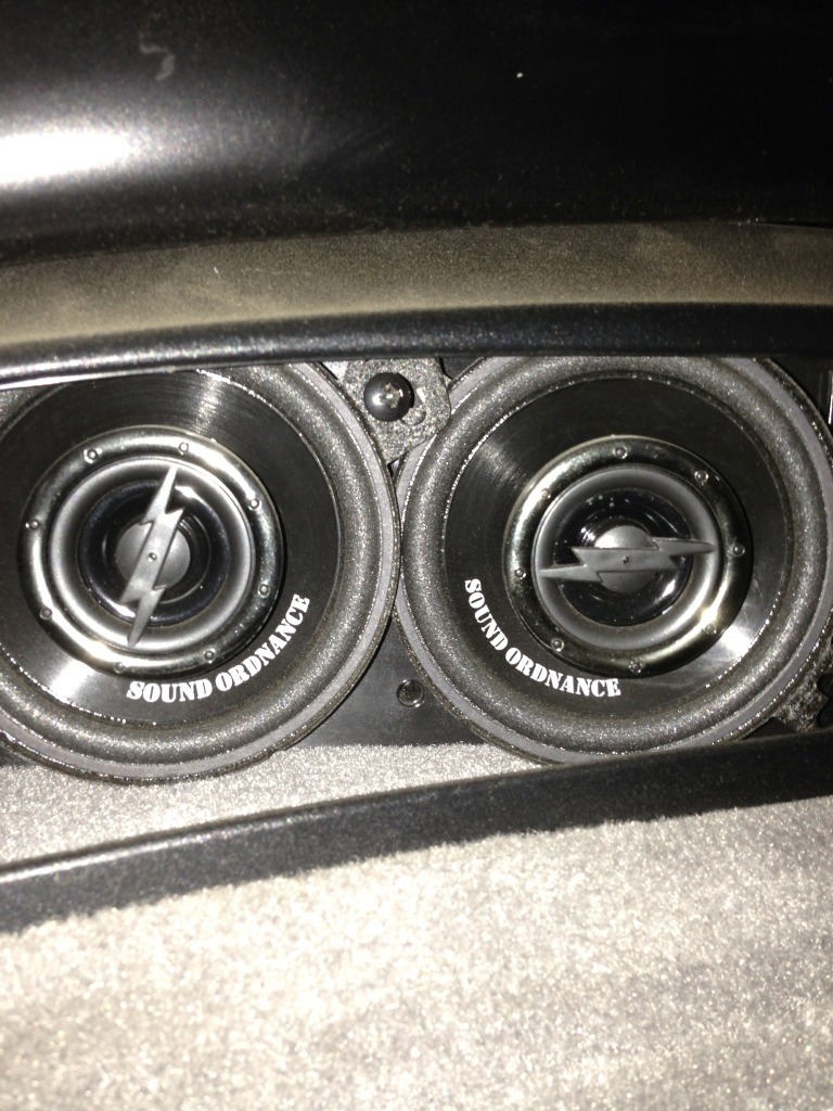

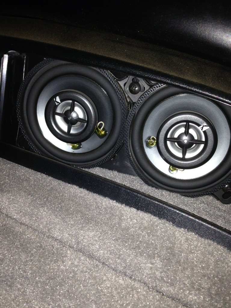

I jammed these 3.5" speakers from crutchfield into the oem mounts. Not the prettiest install but they sound great. I did blow the kicker's after 6 months but replaced with sound ordinance (both $30 a pair). I hope this helps.Name:  ImageUploadedByTapatalk1378168629.148988.jpg
Size:  249.3 KBName:  ImageUploadedByTapatalk1378168642.219628.jpg
