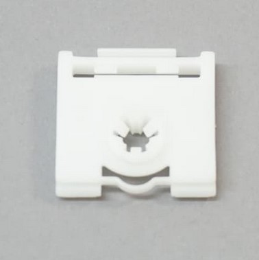

I was curious if each side just uses one clip (986 563 721 00), or if more fastening clips are required.
Also, can the cover strip just be pried off without a lot of force using plastic prietools?
