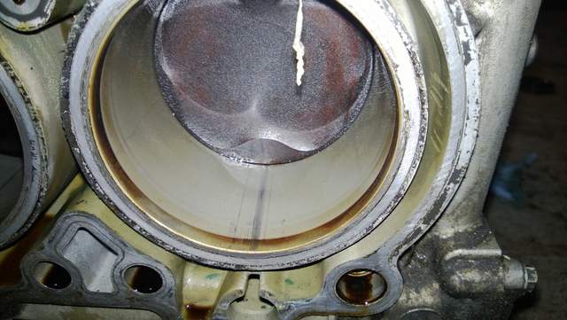

Gents first of all I did not die. Yet. Today we finally took the heads out so we got to the cylinders. Guess what? THERE IS NO ****************ING CRACK.
I will post pictures later but all there is on cylinder 5 and 6 is simply a little wear on the wall. Really minor stuff. We will check what the tolerances are and where we stand at.

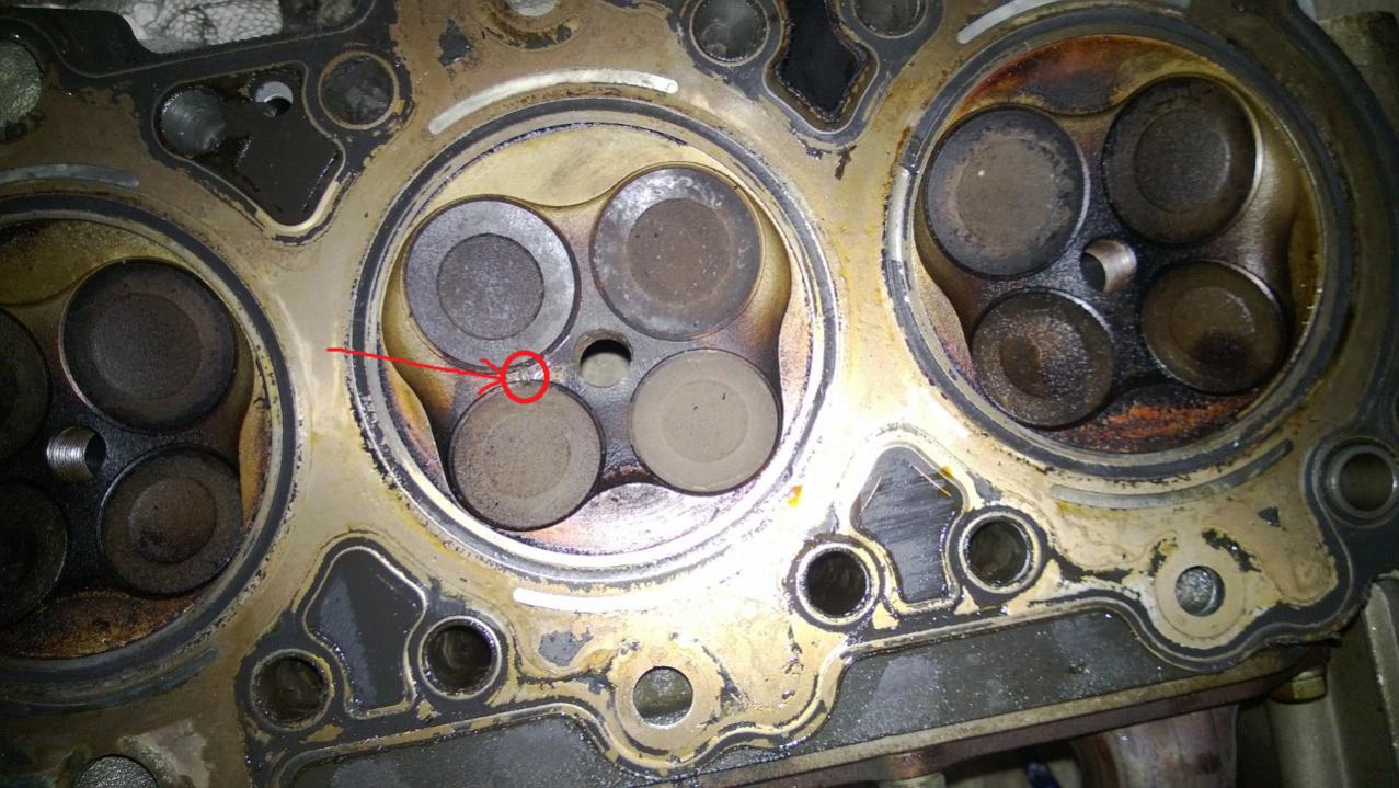

That puzzled us. We know there was no compression so we started looking at the gaskets, carefully looking at the cylinder wall, piston head, etc. Nothing. Next we started looking at the head itself and I do believe we found the culprit. I will post pictures later.
All I can see is on cylinder 5, between the exhaust and intake valves it seems there was a crack at one stage that was repaired. Now looking at the space between the valves we can see a piece of metal, like a rubber band, right there. The valves do not seem to be completely closed and that I do think is what is causing the compression to fail. Once you guys see the pics I think it will be easier to understand.

Ok as promised some pics.
First the cylinder walls on #5 and #6. Some normal, expected wear. Nothing that would create problems or fail a compression test.
Now showing the previous repair attempt on the actual head. Note the "little" metal band between the intake/exhaust valves. This of course is preventing the valves to sit and by simply pouring brake fluid we can see it leaking (what should not happen). The solution now is to take the head to a machine shop and get it fixed (yes, can be done). Or buy a new head (if you are paranoid). After going through this, now that we know the steps required, I honestly do not give a crap. If it happens again down the road we will tear it down AGAIN and fix it AGAIN. So far US 1 x Porsche Failure 0.

This is unbelievable. The picture you guys saw showing that metal piece between the intake/exhaust valves, guess what? It was just a metal piece STUCK right there. Somehow that piece got sucked into the engine and stopped right there between the two valves. That was preventing them from closing properly and therefore the compression test was showing no compression on Cylinder #5.
We are doing a little more investigation but it seems like we are all good to go! Just a matter of getting new gaskets, etc and as we are at it, doing the water pump and IMS/RMS plus a new clutch that I already had in place.
It seems this was just bad luck that somehow something made its way through the K&N filter (the original air box/filter was removed by the first owner - GRRRR).
All this work opening the engine due to a stupid little metal piece! Crazy eh?

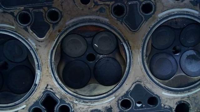

Once we got to the cylinders this is what I saw, after looking for a potential issue (the things we thought were cracks in the wall were nothing but scuff marks, normal after 56,000 miles on any car, just part of regular wear), attached.
Some metal piece made its way to the combustion chamber and got stuck between an intake and exhaust valve. So the valves were never fully closed what of course led to no compression on that one cylinder. Once we took it out the valves closed perfectly as expected. We poured steering fluid on top to see if it would leak and nothing. Perfect seal.
