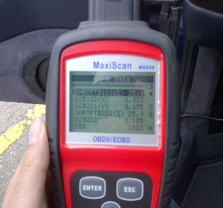

Let me start by saying that i did a lot of research on this forum about these error codes but my problem is slightly more unique. A few month ago i got both these error codes P1128 and P1130. I reset it and drove it a few days before putting in winter storage. I had rough cold idle issue as well. When the car warmed up it ran perfectly. Cleaned MAF and cleaned the throttle body. I think the rough idle was due to bad gas because that went away. Here is where things get weird. Now that i'm driving it in the spring again I got error code P1130 only after driving for a month. I checked for vacuum leaks and replaced my oil filler tube cause i thought it was broken. It wasn't. I reset again and after driving for 2 days i got error code P1128 only.
Does this sound like a MAF failure issue? Why do i keep getting one error and not the other. attached are the read outs for my O2 sensors. Do they seem normal?

The car is running lean. Probably either an intake air leak or failed MAF. Each O2 bank sensor induces independent fuel trim so it is possible to get one code on Monday and a mirror code on the other bank in a few days. You are on the right track.
