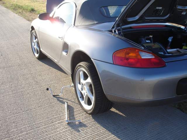

OK, so I got a flat and had some issue with the Porsche tools. The jack I more or less figured out, but how exactly do you take the lug bolts out?
There seems to be 2 pieces in the tools, one that connects to the lug, and a handle that goes through it. Is that it? I used a lot of force and I could not get the lug nuts to budge, but it was much easier with a regular lug wrench.
Did I do something wrong or are those Porsche tools just kind of a bad and inferior to the lug wrench?

No, the original tools don't have much force to them. A socket and breaker bar work much better for removal, esp if they have been on for a while or some tire jockey has over torqued them. There should also be a 6" rod that's threaded on one end. This is the tire guide. You screw it into the hub and then guide the wheel into place. Not an easy job hitting the exact lug hole locations if you don't use the guide.

The stockade lug wrench is only adequate if the bolts are not over tightened. 96ftlbs is the spec, but tire shops often over do it. I was doing the rear brakes on a
Jeep Grand Cherokee last week that was so over tightened that it cracked my 17mm socket. It split right down the side...

The tools in the kit will likely be inadequate to remove the wheel bolts if they have been overtightened, which they invariably are when a shop with impact tools works on your car.
Whenever I have tires removed at a shop, I always check the bolts, they are usually way over spec. They were so tight once I couldn't break them with a three foot breaker bar and had to take it back to the shop to have them loosen them with the impact wrench and then re-tighten with my torque wrench, and the mechanic still gave me the stink eye.

A good reminder that the Porsche tools are of minimal capability and usefulness. I usually keep a small tool kit in the front trunk that includes an 18" breaker bar and lug bolt sized deep socket.

Even if your car didn't come with a spare see if you can fit one. My gt3 didn't but the spare from a turbo did the job.
Throw the supplied wheel brace in the dumpster and buy yourself a good quality 18mm deep socket and 18" arm. Practice standing on it to loosen your wheel nuts - even if they are correctly torqued they can still be a bastard if they are hot.
Do not let anyone do the final torquing of your wheels beside yourself.
