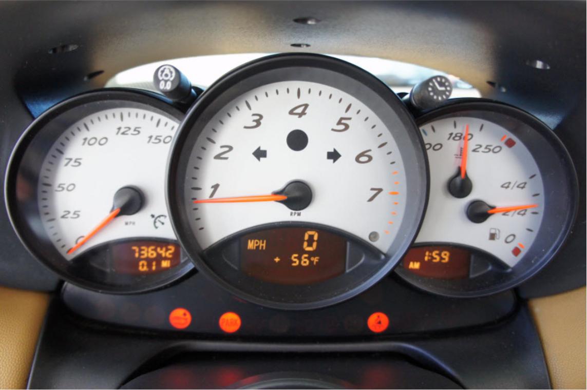

Here are a couple of pics.

Is it just me, or does the Temp. on the gauge show a little on the high side?
I would budget for a water pump as well.

The pictures look great
