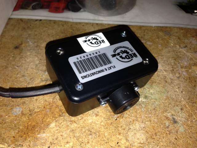

The kit arrived today. Well, the kit's "black box" in fact appears to lack the connections for the additional buzzer/alarm, and the inspection stamp on the box is dated 3-23-12. Sweet!
As I said, I'll survive, but I am mightily disappointed that someone at Pelican was incapable of giving me a straight answer to a VERY simple question.
Oh yeah - I also called them before ordering, and whoever I spoke to assured me that the kits they're selling are the latest generation. I'll install the kit as is, but this has been a frustrating experience.
Perhaps I'm wrong... I'll include a picture of the box. If there's a way to connect an external alarm to this black box, I'd appreciate it if someone could let me know.
FWIW, the inspection stamp:

Isn't that the audible alarm there on the side?

Yes. The latest gen enables you to connect an additional alarm, if you wish. This doesn't appear to be that latest version. I was interested in that version specifically, as some have commented that with the top down, it can be difficult to hear the standard alarm. In addition, for nearly $400, I'd just as soon have the latest, greatest version.

The IMS Guardian has two different versions (with two different prices)
The standard IMSG is what you got an then there's the one with the 12VDC outlet.
I know because I sell and install them.

If that button alarm on the side held by only two screws is indeed the alarm for version one, why can't you just extend the wire connections to it and mount it closer to the cabin or under the dash for better ability to hear it?

I'll try to mount it so it's as close as possible to the dash, as I don't want to tamper with the black box for fear of messing it up somehow.

... not enough juice to drive anything else other than the buzzer.
On mine, I added an extra "idiot light" using an LED bulb so that I can see it when I'm at the track.
But anything external you hook up to it voids the warranty.

The unit pictured does not have the external output built in. It cannot be upgraded without changing the circuit board.
That said, to make this simpler you can send us the system and we'll update it for 20 bucks. The upgraded unit will have a (+) and (-) lead that will allow the use of any 12V accessory light or alarm with up to .5 amp draw.
I know these systems, that unit was built 20' from my office and I developed the entire system. Direct your questions to us for straight answers.
FYI- The "Latest" kits are those with a manufacture date after 8/2012.

Thanks for your response, offer, and straight talk. Question: other than the external terminals, are there any other differences between the pre- and post-August units?

NO. No other differences.
