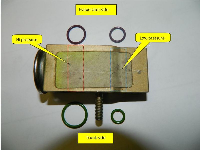

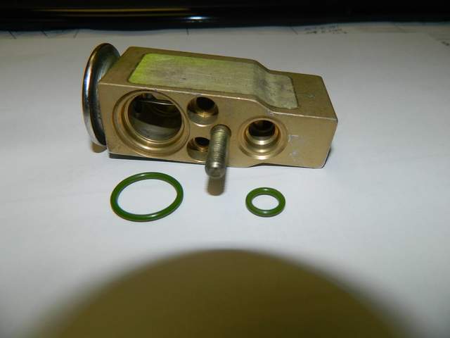

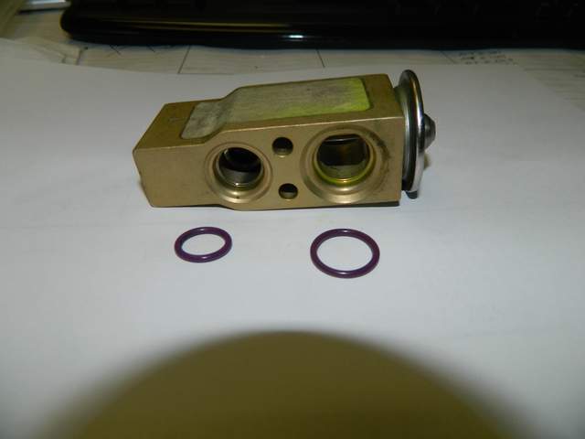

as you can see in this picture, you will need 4 different sizes.
i just noticed that two of them are green, and two are purple (you cant see that from this picture). i'm not sure if it means anything, but in the kit i got, they are all green.

O-Rings placement:
from evaporator side:
from trunk side:
