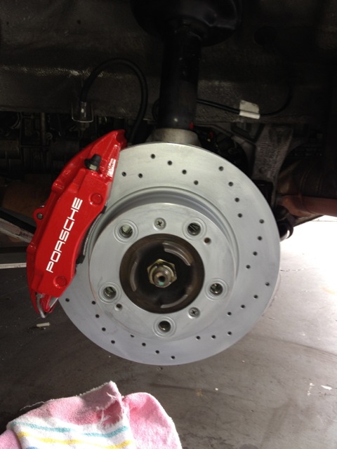

I went with drilled zimmermans. Whatever you buy, make sure the hats are painted or they're zinc plated so they don't rust.
what he said..+1
pic's always helps..

Anybody have an idea what the porsche spec rotor hat paint colour is and where to get it?....or a comparable sub?

I suspect Porsche don't paint the top hats the way they rust after a few wettings by rain and washing......
As for colour match, I just used silver heat resistant paint - VHT if I remember correctly. You can't tell any mismatch once the wheels are in place.
