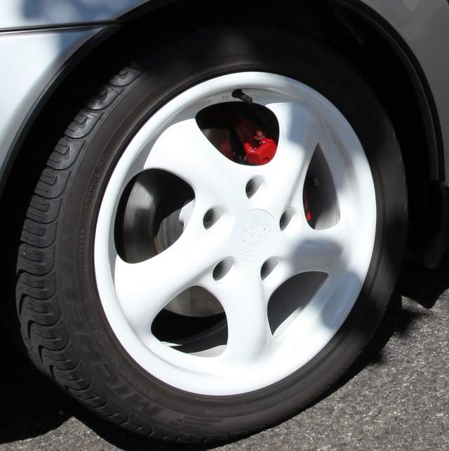

The other day, while stopped at a traffic light, this guy was looking at my front wheel and I am wondering what the heck he is looking at. So first opportunity I looked at my wheels and this is what I saw:

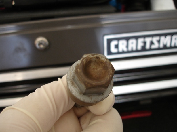

I realized I needed to do something with the Wheel Bolts, they look terrible. I thought about replacing all the bolts but a good friend of mine (owner of German Parts and Restoration) recommended I get some paint instead… So I did.
I found this wheel paint at Pep Boys; it’s “Track Tested” so it must be real good right? Paint color is: HWP 101 Silver

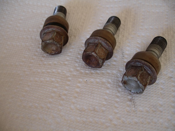

Even after removing the bolts and cleaning them they looked rough.
I sprayed a thin coat of the paint on the head of the bolt; the paint dried extremely fast, surprisingly fast, and was hard as nails.
I used a zip-lock back over the bolt head during installation, this works great.
End results look great.
This task did not take long, I did not jack-up the Jägermobile, I just removed a couple bolts at time, and since the paint dries so quickly there was very little waiting for the paint to dry.

Here are a couple of angles. Sorry if they don't hit it just right, but black lugs on a white wheel in the day are tough to pull from shadows. Tried it with the flash and it was even worse.
Nice thing is the rust is gone. I used Krylon flat black high temp paint and had to test how good the paint is already. Les Schwab mounted one tire backwards I didn't catch till I was back home. Used lug wrench with no coating and they came off with out a hitch or scratch.

I removed one bolt today with a six-point socket without a plastic bag... Looks like I scuffed one area a little bit. Since the instruction on this wheel coating product say it fully cures in 7 days, I will remove a couple bolts next week and see how the finish holds-up.
I use a wheel cleaner every time I wash the car, most likely the chemicals in the cleaner accelerated, or caused, the corrosion in the first place. Hopefully this new coating will eliminate that from happening again.
