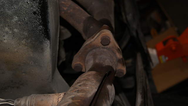

With WD-40 RUST RELEASE, and 15" channel-locks, exhaust off in 30 minutes.

The WD-40 RUST RELEASE unfroze most in 5 min, the rest may take a little heat from Mr Smoke Wrench

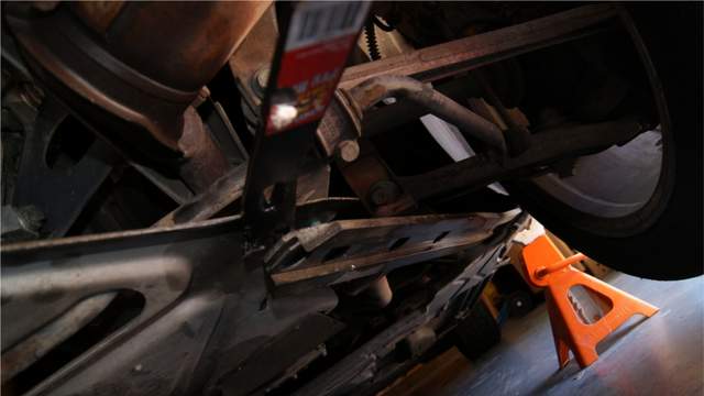

Removing the 10 bolts of the aluminum pan,
Undoing the anti-sway bars,
Use pry bar to get apart,
Pull the aluminum pan to the back of the car, it takes a medium tug.

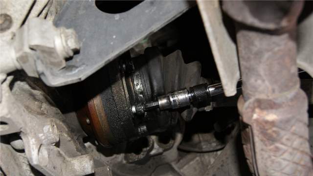

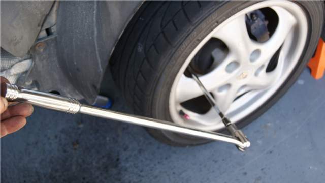

Undoing the CV bolts, use a brand new torks socket , this will give the best bite into the head of the bolt,
Run an exstention to the outside of the car,
Use a hand impact driver, hit 4 or 5 times to loosen.
Use braker bar to gently nuge bolts free. Push gently and they will go.

Never seen or thought of the "extension through the wheel" approach, watch out for buggering up the wheel paint (pic looks like it's a bit late). I also removed the rear bumper, makes it alot easier. Do not forget to lock the cams.
Yes new wheels are on the list of replacements
