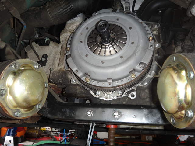

Updated clutch release lever assembly.
http://986forum.com/forums/uploads01...1344256030.jpg
New LUK clutch kit note all Sachs parts included in the kit. Also included INA pilot bearing which was the same as the OEM when I removed it. Both used INA pilot and throwout bearings.
http://986forum.com/forums/uploads01...1344256280.jpg
