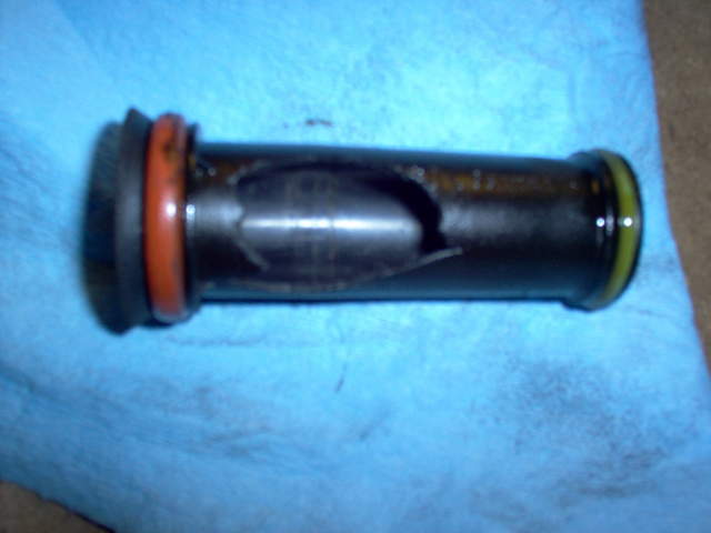

I got the tube out. This what I have.

There's a picture that tells a story. What were you using to pull the tube out?

I wasn't pulling the tube. Just changing plugs. I went high with the socket & extension heard a snap.
