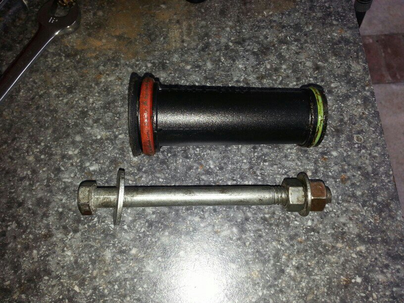

healthservices 04-07-2014 10:39 PM
A simple bolt, a couple of washers and a couple nuts will get out even the worse glued in ones. I made it because the transom plug idea does not work for the super stuck tubes.
Simple yet effective...
http://986forum.com/forums/attachmen...9206061365.jpg
Attachment 18071http://img.tapatalk.com/d/14/01/09/ura9ynyb.jpg
Stick the bolt in so the washer catches the inside lip...
http://img.tapatalk.com/d/14/01/09/uga4e4ev.jpg
and use a screw driver or other prying device to pop out
http://img.tapatalk.com/d/14/01/09/y7ujyba5.jpg
Took longer to post this than it was to pull out the tube using this method :)
Sent from my SAMSUNG-SGH-I317 using Tapatalk
healthservices 04-07-2014 10:41 PM
Oh of course pull out the spark plug before using the tool
Sent from my SM-T310 using Tapatalk
