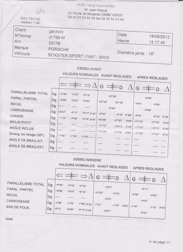

Just bought a nice Boxster and am enjoying it a lot. But there is one thing that keeps bugging about the handling. It does love corners but it seems to wander about a bit when going straight. It does not have a preference for left and right, it just does not seem as 'planted' as I expected it to be. Now I am not novice when it comes to performance motors (changes in a track equipped Lotus Elise for this Porsche and owned other sportscars) so I know it will be be like the Merc S I use for day to day driving, but I just did not expect this.
I did check tires, pressures and had an alignment done. That helped a bit but it is still not what I expect. It could be just how the car is, it could also be that there is something wrong. I am attaching the alignment report, It's french but I'm sure it will be readable for the people 'in the know'. The garage who done it is one we know well, they do a good job and they love working on my cars instead of the standard load of Renaults and Peugots.

I have no French so I can't read your alignment specs but.... In my GT3 and my Boxster if I am setting them for the track I reduce the the toe-in to 0". Helps with turn in but has the effect of making it wander in a straight line - which does not matter on a track but can be annoying on the road. Is it possible that you have a little less toe than the factory calls for?
