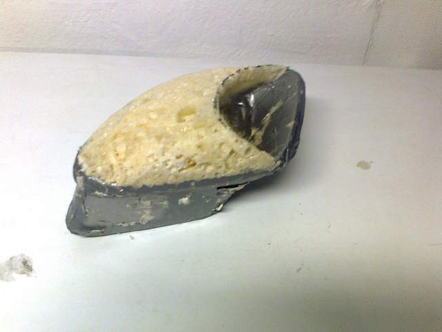

OK, so I started a project I can not compleat
I thought the price for these things were a bit high and as I only want one for the air intake side and it is a racing car - I figured I would do it myself (or at least try to!)
I did some reading and understood that the best way was to make the initial shape with foam and that is what I have done - but now I am not sure about the next step?
Do I just cover this with fibreglass and then scoop out the foam?

If you are happy with the shape you have, it would be prudent to start off by filling the voids with bondo, sand and shape to back to smooth and then begin the process of laying glass.
From what is seen in your pictures, you appear to be very close to a final size you are wanting to end with. This will be a problem as you lay glass and resin you will build up a considerable thickness. You should consider giving yourself at least 1/8 to 3/16 of an inch of room for glass build up and then final sanding and finishing.

What I see here is that you taped up your existing piece and poured foam in the opening, then cutting it out to form your shape. This forms your 'plug' and is the first step to creating a mold if you wanted to create more than 1 copies of the new part. However, the problem with your 'plug' is that all the surfaces are very unfinished ( tape lines, ect ) and will show through to your mold and finally to your finished part.
If you wanted to go for a 1 off piece, that's a problem too .. You cant just lay glass on top of this anyways, the tape would prevent all adhesion to the actual piece, so the only thing the glass would actually stick to is the foam ..
Hate to be the bearer of bad news but IMHO, its a redo. Hopefully I'm wrong and some other expert chime in.

Thank you both for the feedback and good comments. Sounds like I have demonstrated that a little knowledge and no experience is indeed a bad thing, and I have to scrap what I have done and would be better off just purchasing the finished product...

If you lay the glass cloth over the foam and epoxy or resin it. It will stick to the foam. You need to entirely cover the foam mold with release fabric so it'll release after it cures. For something like this it's best to vacuum bag it. Too bad you are far away or I could help you out. But again it's cold here so the resin has jelled. Look around for boat builders as there are some in Finland and they might be able to help you out. Check f-boat forum in yahoo.
