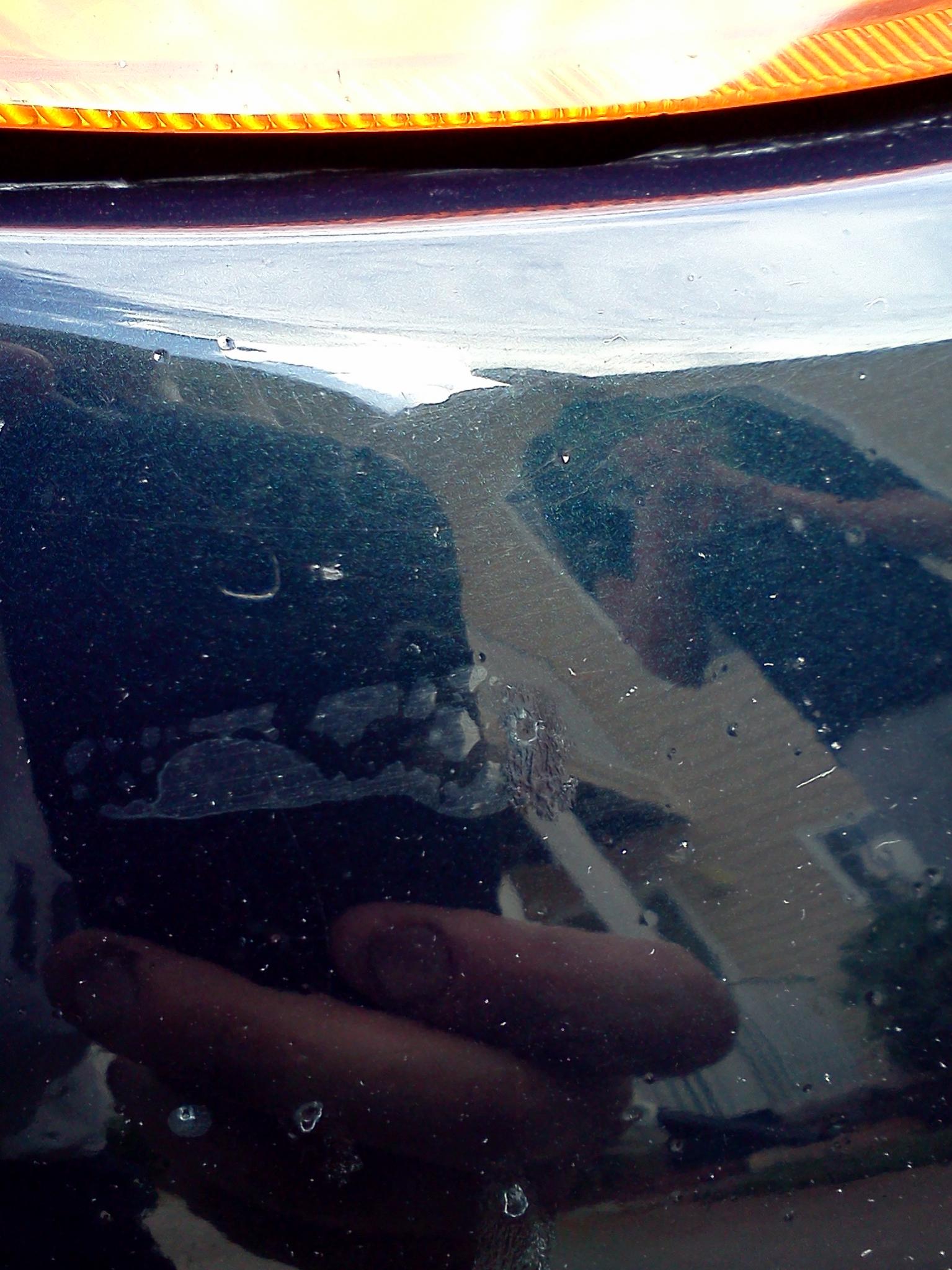

John99Boxster 11-13-2011 02:03 AM
It is not 3m.....it is def. the clearcoat. the paint underneath looks great.
I saw a can of clear coat remover at Auto Zone Yesterday.....could I just remove the flaking clearcoat and then reapply new clearcoat?
John99Boxster 11-13-2011 02:15 AM
Here is a pic.
http://986forum.com/forums/attachment.php?attachmentid=15636&stc=1&d=13211829 00
peterbrown77 11-13-2011 04:04 AM
"It is not 3m.....it is def. the clearcoat. the paint underneath looks great." - is a little contradictory. If it is the clearcoat, the paint will be a bit dull. If it's a film, the paint will look great.
John99Boxster 11-13-2011 04:08 AM
I suppose you are correct....Its almost as if someone put Clearcoat OVER the clearcoat???
The "film" that is peeling is a hard plastic....if that helps

John99Boxster 11-14-2011 02:32 AM
3 Attachment(s)
Better pics
http://986forum.com/forums/attachment.php?attachmentid=15642&stc=1&d=13212703 34
http://986forum.com/forums/attachment.php?attachmentid=15643&stc=1&d=13212703 34
http://986forum.com/forums/attachment.php?attachmentid=15644&stc=1&d=13212703 34
Burg Boxster 11-14-2011 04:32 AM
ok, now I'm with you. Definitely looks like a respray which wasn't cured properly... basically a quick masking effort - especially if bought through a dealer. You're best bet would be to take it to a quality body shop and have it resprayed (and cured) properly. Should be $600 or so.
