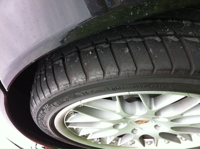

My PS2s began to melt after 4 track sessions on Sunday. Has anyone seen this happen? Is there cause for concern?
Check it out..

looks normal (at the upper end of the scale) to me
After a few hundred kilometers they should look fine again
Maybe next time with dedicated track tires...

yeah, not bad. your tire pressures may have been a TAD high (1-2psi)

Okay thanks guys! I was running 32f 36r; it was cold day too... so not sure where to go with pressures next time

I just think your tire's were just picking up other car's R compound rubber. Look normal.

Technically those arent PS2's, they are Sport Ribs. Sorry, I'm a stickler for detail...

I experienced the same tire "melting" with my set of PS2's after a few sessions at the track. This is normal. The tires now might make some strange rumbling noise on the freeway until the excess melted rubber wears down - this is normal too. I actually stopped and checked because it sounded like I had a loose wheel.
In 3-4 weeks when the excess rubber has worn down, you might want to have the tires rebalanced since so much of the tread has changed due to the melting.
I found that a an alignment with as much negative camber as you can get was helpful in reducing the load and temps of the outside of the tire during hard cornering. However, it will also add more wear to the inside of the tires on a daily basis so you'll have to consider the trade offs between inside tire street wear vs outside tire track wear. Tracking a street car is all about tradeoff's!
After my PS2's wore out, I went to another high performance tire that was more track oriented and have not seen the same level of melting even on hotter track days. Look for a tire with a tread wear rating less than 200. There are several brands and models that meet this criteria such as Hankook Ventus RS-3, Kumho Ecsta XS, Bridgestone Potenza RE-11, etc. Do a search on TireRack and sort by UTQG (tire wear) and you can eval from there.
Of course, lower tread wear tires will stick and wear better on the track but also wear much faster. Another one of those darn tradeoff's!

These were cold pressures...the beads on the front were from my tires there was additional pickup as well

track pressures all depend on driver, tire size, tire compound, alignment, ambient temp, track temp, track surface grade, relative humidity & about thirty other factors......
if you are using air (vs. nitrogen), your back tires will tend to increase about 6-10psi and your front tires will increase a little less; maybe 4-8 psi. at jaykay's cold pressures, he was likely well into the 40's hot. this will cause treadwear & temperature issues.
jaykay posted two pics; the first one shows some mild overheating toward the center of the tread. if he would have driven extended sessions, i think he would have started to see a bit of chunking here. the little blobs are just pickup from the track & are no big deal. the second picture looks fine to me.
tires are a funny thing. they will respond in a specific manner to a POINT. then, they will respond in the OPPOSITE manner. tires have a sweet spot for temp & pressure. within this sweet spot, adding pressure will increase the efficiency of the tire, resulting in MORE grip. a common misconception is that less air = more grip. this is only true when you are outside this sweet spot.
