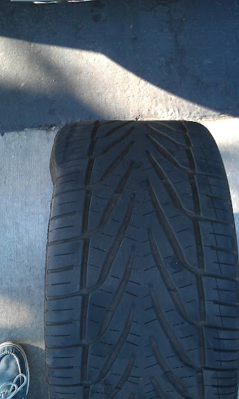

  • Random pipe from engine (picture below)

And a few pictures mentioned above:

As for the vibrations, it wasn't a balance issue. Look at the tyre that was on the back:
No idea what has happened. Maybe the tire is just very old? Anyway, not safe. I've replaced it now with the spare tire for now. All the other tires were fine..
