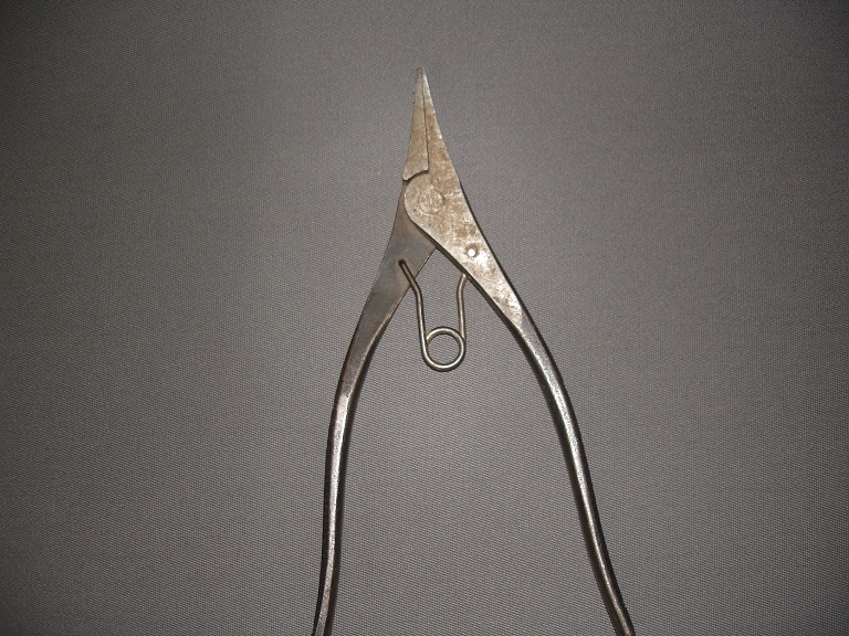

My method is very similar to Timothy's except I use this tool (pictured). Makes the job very easy, instead of pulling apart the handles I squeeze them together to separate the pads. I believe Sears carries a similar tool.
