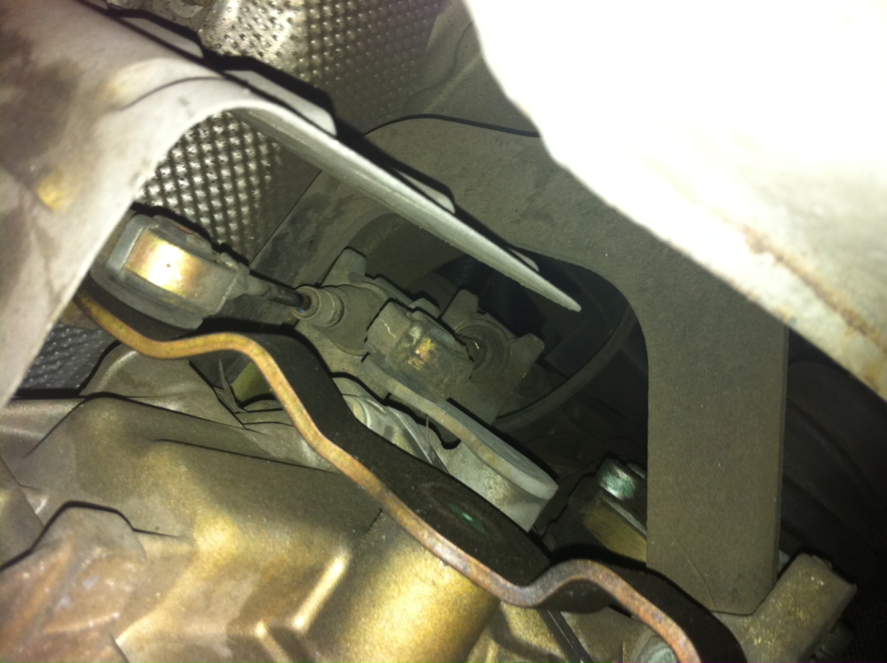

Just jacked up my rear and had my bro move the shifter around. I see two cables. It appears the one on the top corresponds to left and right movement and the one on the bottom represents up and down. They both move and i don't see anything apparent that is deattached. This pic attached is what I can see. Is there something specific on the cables I am looking for? Or as long as they move, they are connected? The only difference is the movement in the bottom cable is shorter because it can't get into gear.

so i decided to play with the shifter one last time before I was going to tow it tomorrow. I jammed it into 2nd really hard and it went through. after that, all the gears seem to be engaging again. Any ideas on what might've happened?
Do fluids have any effect on gear selection when the engine is off? The s has 70k miles on it and im pretty sure the tranny fluid was never replaced.

Was this all just sitting in the garage with the engine off? Sometimes if nothing it spinning the teeth in the dogrings are just not aligned with the recesses in the gears and the tranny won't go into gear. It's not a problem when the engine is spinning because the sncros bring everything slowly into alignment.
