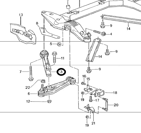

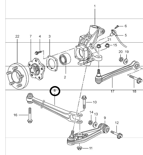

Dirk, front or rear (3 or 8 in diagrams)? The front is easier to get at for us jack it up in the garage guys.
