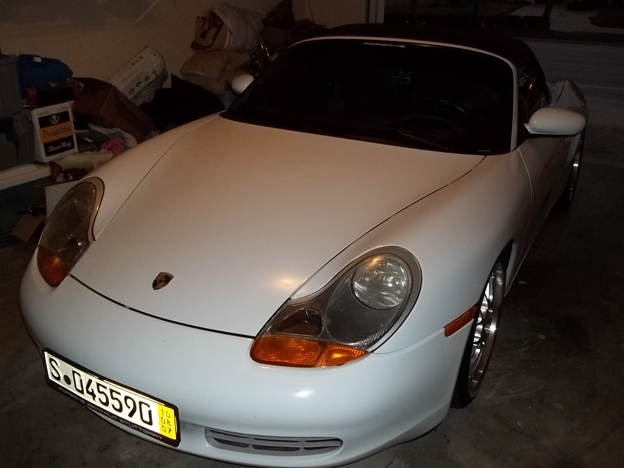

Old 04-08-2011, 04:14 PM   #24
Join Date: Jun 2007
Location: Freeport, New York
Posts: 472
Fast:
Your Boxster looks like it's smiling!
What happened?
Regards, Maurice.
schoir is offline   Reply With Quote
