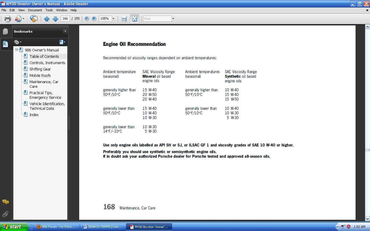

The manual recommends regular oil or synthetic oil. I always thought only synthetic was recommended??
ANYONE RUN REGULAR OIL IN THERE BOXSTER without problems?
