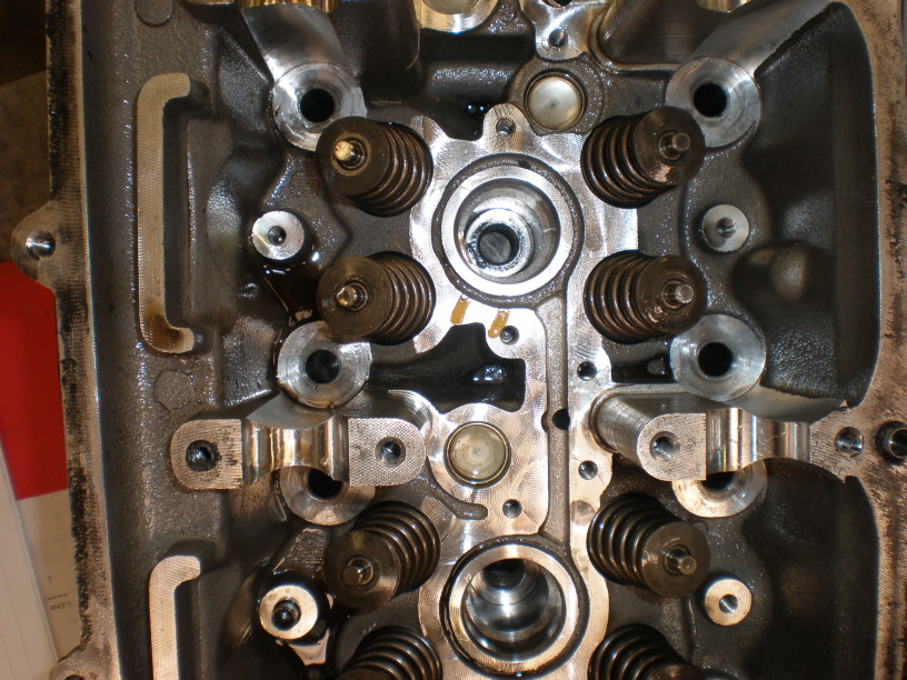

Some examples of cracked heads. All of these came from 2001 Boxster and 996 engines.

Overdrive 10-25-2010 10:17 AM
this is the pic I'm referring to, Jake...I can't see a red circled area here. I saw your circles quite clearly in the other photos, and the damage could be clearly seen, regardless. I'm just wondering if there's some glaring obvious thing that I'm not seeing....
http://986forum.com/forums/attachmen...chmentid=13258

Jake Raby 10-25-2010 12:44 PM
That crack was so small that it could only be noted with a hot water pressure test.. Thats why we marked the area with yellow anti-sabotage marker. I used that pic in my M96 engine rebuild school to illustrate the area where heads generally crack. Its the "big picture"
If the water pump on your M96 hasn't been replaced, replace it. Replace it every 3 years after that.
Here is a crack that no one can miss.. Its wider than the Grand Canyon.
One day when I have time to put all these on my site, the world will have a heart attack!

Overdrive 10-25-2010 02:02 PM
Thanks for clearing that up, Jake. I see the marker you're talking about. As for the picture following that (the Grand Canyon's competition), that's just painful to look at...what a way to K.O. an engine.
