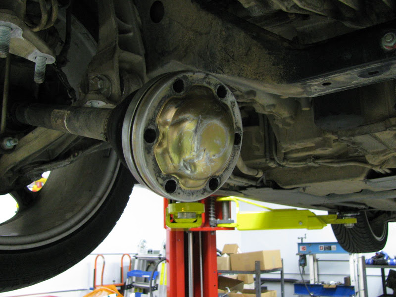

I had a similar noice...clunk...cluck....cluck sound, real loud, did not sound good at all. Took it to the dealer, they said the brakes were sticking, cleaned then up, went away for a couple of months, then it came back.
I didn't want to take it back to the dealer, $400 for nothing, so I took it to an Indy should, they opened it up and found the below damaged, which was causing the issues.
If after you jack up the car, the noice goes away, could be this, this is what would happen to me. If could also be the trannmission as well? I'm getting a rebuilt not, broke 2nd gear, and that sounded like a bunch of rock in an tin can...all other gears worked fine.

ok got it jacked up, put it in gear and it took about 3 seconds to figure out what it was.
i'm not sure but i think that's the e-brake cable line. if someone could confirm for me.
looks like a zip tie broke off that was holding it away from the wheel. when the wheel goes around, the weight on the inside hits it (you can see how it's worn away the weight, which might explain my recent rougher ride).

I believe that is your e-brake cable.
btw, I've never known wheel weights to be placed in that location as seen in your picture. they're usually inside the rim. are you sure the weight didn't move?
Before:
After wacking it back to shape:
those darn self-tightening bolts again

thanks guys, that's all it was. i zip-tied the line back down and the noise is gone. all is well again.

Wanker Yanker,
You are a stooge but hey if you want to keep bringing it up then fine.
This is a quote from a British engineering firm that specializes in bolts, bolt tightening and bolt failures.
In the UK, loss of the wheels from the left hand (nearside) rear drive axle seems to be most common and this is thought to be due to the effects of road camber and the fact that these wheels are subject to both braking and driving torque. However, as almost all wheel studs have right hand threads, which are tightened in clockwise direction, there have been several suggestions that the use of left hand threads for the left hand side wheels would overcome the problem. Again whilst this may prevent full unscrewing and loss of the nut it does not address the main cause of loss of tension in the fixing following initial tightening and the wheel would eventually be lost because of fixing and /or wheel wear and fracture.
http://www.boltscience.com/pages/failure4.htm
Rotation direction and centripetal forces do have an effect on bolt loosening. This is what I was referencing in my orginal statement. If instantaneous acceleration of the part is high enough then it will tighten the bolt (example: crankshaft bolt on diesel motor) or conversely loosen it. If you read this excellent website that I have provided the link to, you will find that multiple forces are acting on the bolts in the Boxster axle. I would also conclude quite readily that loctite would be a good tool to reduce failure of this joint for those other nay-sayers. If you don't believe me watch the video of the Junkers machine.
If you want to bring this up every time a halfshaft is mentioned on this board then I will be happy to oblige you and prove my point even further.
EDIT: PS, the photo of the 986 halfshaft is the left side....Golly gosh gee whiz
