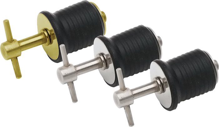

Maybe you could find some high temp silicone plugs that are used for powder-coating that might fit
