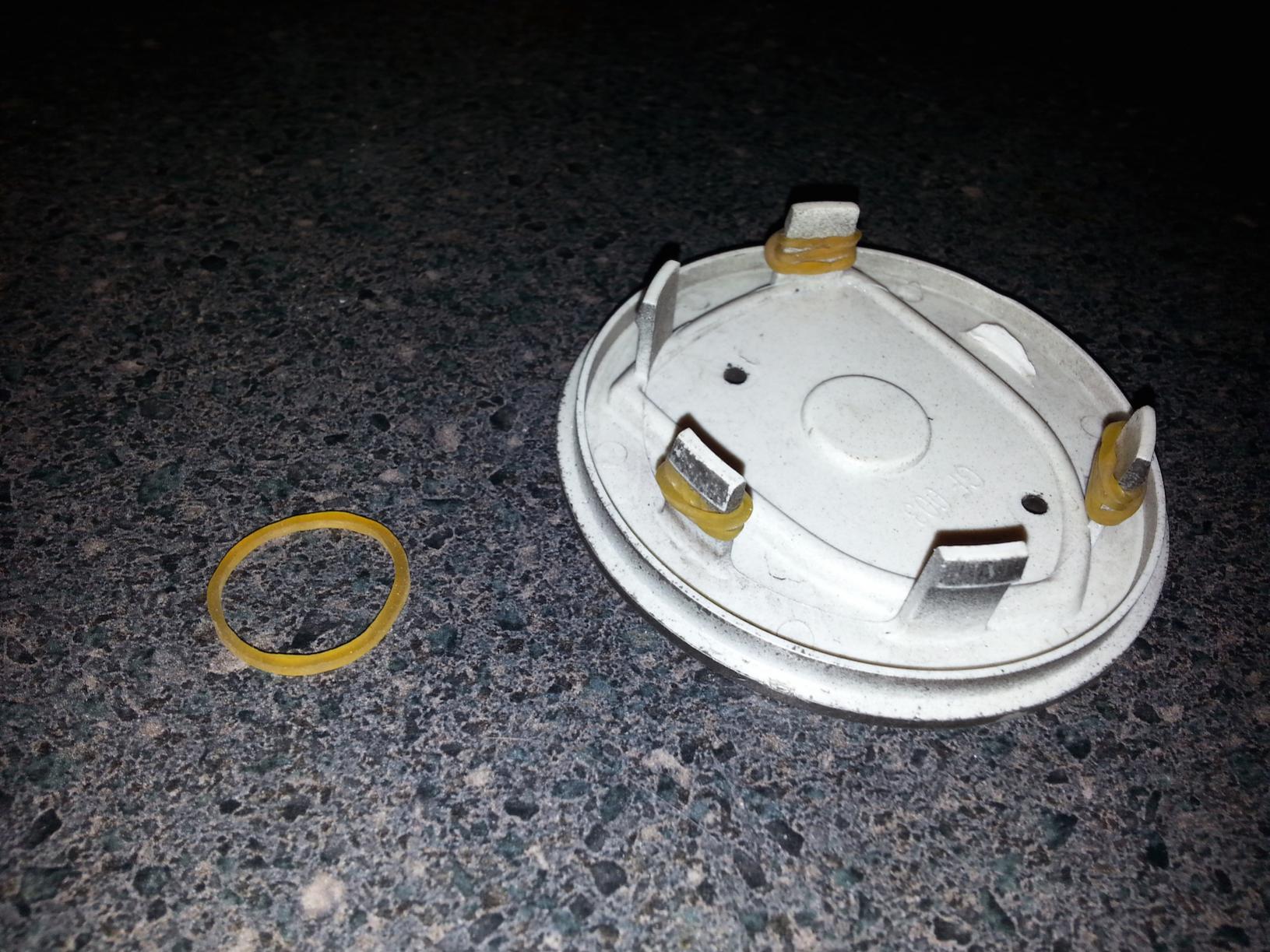

Fix for loose center caps
I picked up a set of 17x6.5 Cayman wheels for winter use, and noticed that the center caps were loose enough that they seemed like they could fall out, and two of them had broken tabs.. I suspect that these might be aftermarket caps.
Here's the solution I came up with such that they are now stable, but should be easy to remove for future mounting/balancing.
