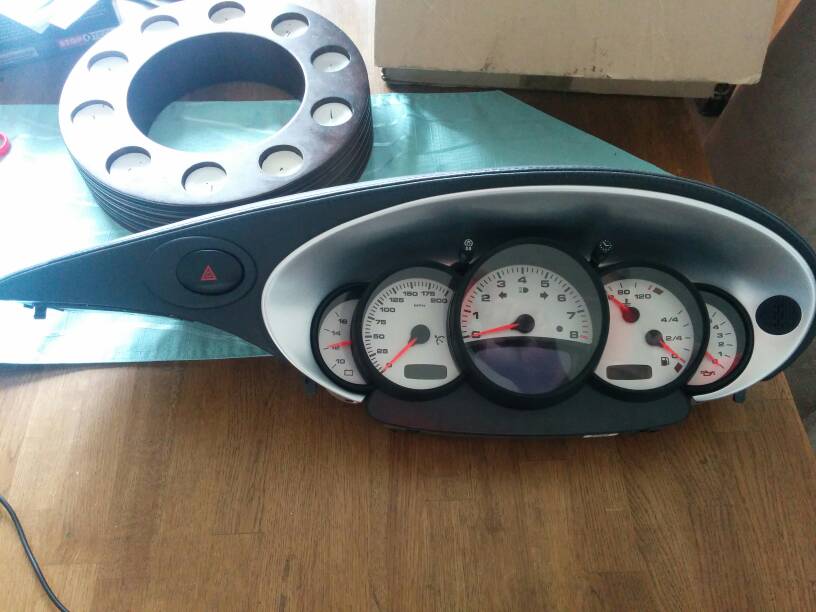

Originally Posted by danch View Post
These arrive today : 2003 C4S Cluster & Binnacle $240...bargain
Attachment 18563
Mileage is within 500 miles of my own & already has the obc activated so should only need the DME portion done if I have read it right.
Also received the pressure sensor to fit also so hopefully get these fitted next weekend
Best way to do this is to copy and paste your old clusters file onto the new cluster using an EPROM programmer.
That way, the VIN will match and you won't have to worry about the odometer not matching when/if you ever sell the car
