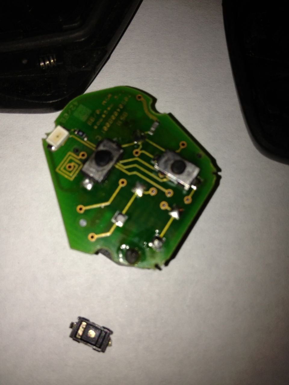

Order a couple tactile switches for my backup key fob.
The main arm/disarm locking switch was broken and missing the button.
I moved the front trunk unlock button to the main arm/disarm position.
These switches are tiny...
Thanks for the link to the site.. I updated the link to include the switches for anyone else. 101-TF25R-EV Mountain Switch | Mouser
