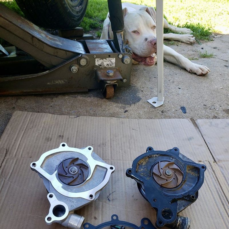

I've been enjoying the car, taking care of a few little things as I get time. I made a short video of what a failing water pump looks like while I was doing a replacement. For a replacement pump, the people I trust all recommend a Pierburg pump. Water pumps are not a part that you want to shop for the cheapest....

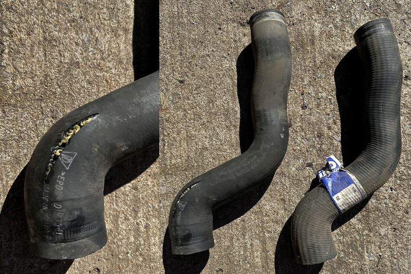

I found that one of the main coolant hoses from the engine had split – the one that I hadn't replaced five years ago. And the hose to the heater core was deteriorated and bulging.
I replaced both hoses and asked the owner if she'd like a new water pump while I was at it since the one on it was about five years old. I had two new Pierburgh pumps on the shelf, so I didn't have to wait for parts.

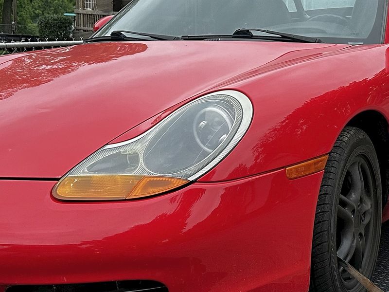

Lastly, I noticed that one of the 'experimental' LED headlights that I had installed had come loose and rotated. When I made them, I hadn't planned to keep them in the car, but my friend who bought it liked them.
I was able to rotate it back into position and tack it in place with some JB Weld epoxy. I told the owner that it would be best to plan on reverting back to stock headlights in the future, but they are good for now.
