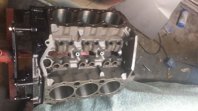

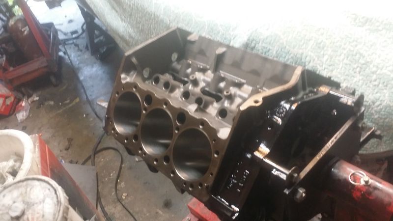

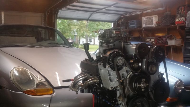

Qingdao 09-28-2020 03:42 PM
OOOH boy the shiz is getting real.
I got my block back from the machine shop. Just need pistons .060 over; this ain't no 4.3 its a 4.4. lol I round up.
http://986forum.com/forums/uploads02...1601332580.jpg
Of course rustoleum black.
http://986forum.com/forums/uploads02...1601332621.jpg
AND I added a second pane to the back glass. I was not satisfied with the sound/heat deadening that a single 1/4" piece of plexiglass can provide. I also put about 15 pounds of sound deadener to the firewall under the carpet.
I also re-did the window tint. While the pre-cut stuff is easy to use; it was short. Like half a cm short on the bottom so when the window closed all the way (door closed) there was a strip of non tint on the bottom.
http://986forum.com/forums/uploads02...1601332819.jpg
http://986forum.com/forums/uploads02...1601332954.jpg

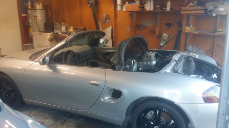

Qingdao 10-04-2020 03:40 PM
The Box is all like "Please be gentle good sir" and that Chevy is like "HELL NA; I'MA RAM IT DOWN!"
http://986forum.com/forums/uploads02...1601851163.jpg
But seriously I'm so close gotta get longer push rods and figure out a correct belt length... then its just a matter of sliding this bad boy in that purty gurl.

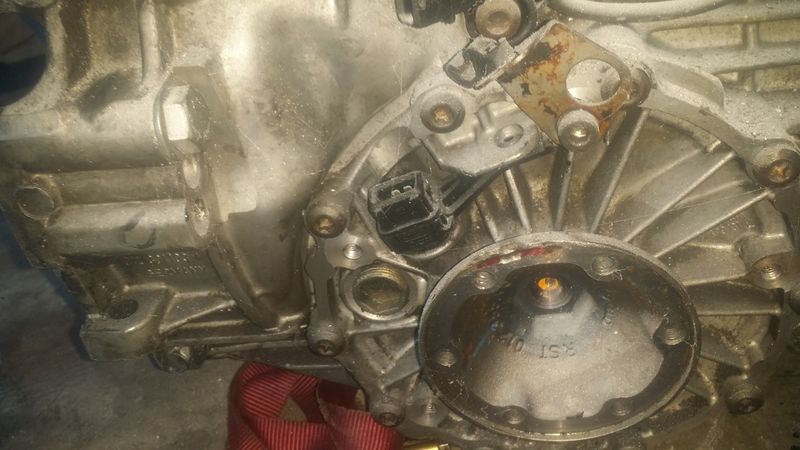

Qingdao 10-12-2020 08:00 PM
O M G... Everybody talks up Kennedy engineering.. Oh man Kennedy is the bomb digity. Oh Kennedy makes some sharp shiz. BUT Dagnabit (I'm using softer words) I was gonna do some real hatting on Kennedy the other night.
I went to put in my trans on the KEP adaptor plate. I had previously (as seen on this thread) mocked the engine and trans up in the car. No problems right??? But when I went to put the trans back in for real this time I ran into a big snafu. One of the bellhousing bolts for the SBC is in the same spot as the Porsche bellhousing. I know thats not necessarily KEP's fault, but at least they could have not made a hole there or made some kind of note about it. SO I took the trans back out (what a pain). Cut a chunk out of the Porsche bellhousing.
THE Next attempt at re-installing the trans... I had it all bolted up with all the bellhousing bolts in place. And I went to put the starter motor in. CLUNK :confused: I hit the Porsche bellhousing. Apparently you have to cut out another chunk of the Porsche bellhousing to get their starter to fit. OH man I was cursing when I took the trans back out.
ANYWHO, alls well that ends well. I cut my chunks out and re-installed the trans.
http://986forum.com/forums/uploads02...1602557650.jpg
^^^ Thats the area in question that anyone following me (I doubt there are those as crazy as I***) can use as reference on where to cut.
Here is the old girl sitting all pretty in that engine bay.... I just wanna cry its so beautiful.
http://986forum.com/forums/uploads02...1602557808.jpg
So I asked on FB and someone politely responded to my inquiry, but I'm retarded and even more so when it comes to electricity. What color wires, or which pins do I need to make wires go to to make this sensor work. I feel like this is a VSS which is something I want and I accidently hacked it off. Does anybody have a wiring diagram I can follow the VSS wire to a source or know off the top of their heads which pin on what I need to make a wire to make this work?
http://986forum.com/forums/uploads02...1602557981.jpg
***Or just touched in the head??

Not sure if that helps you any way, but on my car this connector is blank, wasn`t used and capped off. The only cable that comes from the tranny is the reverse gear switch. Perhaps it`s optional and the speed signal for the speedometer is coming from the ABS sensors?
WizardSmokey 10-17-2020 12:31 AM
The connectors on the trans is/are either the neutral safety switch, and/or the reverse lights switch. The speed comes off the ABS reluctor on the hubs.
I guess you guys are right. Its not like me to just toss out a connector; especially not one that came off the trans.

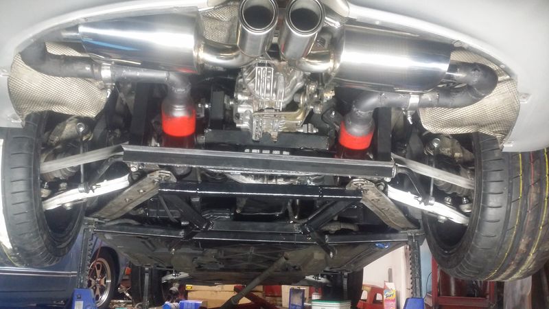

Qingdao 10-24-2020 07:06 PM
It sounds good... Just like a well muffled truck. Just what I wanted. If you're in a parking lot and I'm idling you'd be looking for the S10. LOL
http://986forum.com/forums/uploads02...1603591219.jpg
http://986forum.com/forums/uploads02...1603591298.jpg
I did unfortunately blow out like all of my intake manifold gaskets with backfire... Might have something to do with my nitwit plug wiring, but that gives me time to make some new ones. Also, gives me some time to trim the UIM down a little to allow for better timing control (the big distributer can't do a full 360).
All the wiring is done; just have to wrap it and tuck it. To give a tentative timeline I'd say a week or two and I'll be on the ground ready to tune the old edelbrock. :D

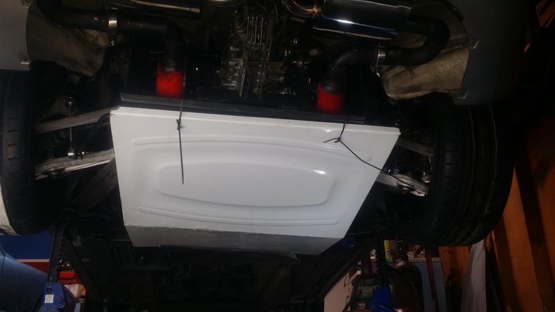

This is what happens when you have the plug wires in the wrong spot and your engine says "CHECK YOUR TIMING" and you are like "F YOU I'm gonna pour more gas in the carb". Oh well I really shoulda clear coated that adaptor plate anyway. :D
http://986forum.com/forums/uploads02...1603763066.jpg
And I picked up a piece of garbage on the side of the road today... then I put it on my car.
http://986forum.com/forums/uploads02...1603763273.jpg
Well, I was thinking that air, being a fluid, would find the vacancy in the engine bay of my car the path of least resistance... then slap a Z-art top over that vacancy and I'll get all kinds of rumblings that I don't want. SO I wanted to make a belly pan of sorts (to keep that naughty air going out the back of the car). I found a washer machine on the side of the road near my house and I picked it up. Fits pretty well, I just need to do some trimming and paint. BUT I think its gonna do well back there. It fits under the OEM plastic trans tunnel (??) panel; so I don't think any excessive air is gonna really find its way into the engine bay.
BUT at the end of the day I know its just gonna look like I have a washer machine under my car. ROTFLMAO :D :D :D
