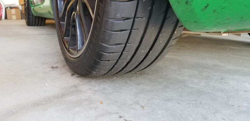

Was able to get on the track on Sat by running in a lower run group. The day was hot from the start, so no chance for any quick laps. After lunch I checked my tires and found this on all 4:
Game over, almost. I did the last session of the day as kind of a lead-follow for one of the novices who was having trouble with a cpl corners. She wasn't running very fast in her Macan. I didn't drive on Sun, but got to instruct the student from the lead-follow as her instructor needed to assist her husband with the club race. We worked thru the student's issues and got her to solo the last session. Made it home w/o any issues and now I'm watching 4th of July tire sales for some new shoes.

Wow, thanks for sharing! 3 seconds shaved off from a gearing strategy is awesome!
I am curious which tires these are and how old are they?

My tires are / were Bridgestone Potenza Sports. They are a little less than 2 yrs old with approx 6K mi and 5 DEs on them. I have camber at -2.2 frt, -2.0 rear. I normally get 3 yrs out of my tires w/ 3 DEs / yr. This was my first set of Bridgestones and I wasn't impressed. I would list them behind the Mich Super Sports, Conti Extreme Sports (not 2), and Yoko Advans I've previously run (and in ranked order).
I'm not sure if maybe I caused some of the damage to this set. I normally chase pressures and measure to a pressure after each session. I did that on Fri, but it quickly got to 100 on Sat and only bled after the 1st session. I knew I wouldn't be cutting any quick laps at that pt so I didn't cont to bleed air. That might've caused too much heat in the tires and blistered the edges. I plan to talk to the other 2 ppl I know who blistered their tires and see if they were chasing pressures or not.

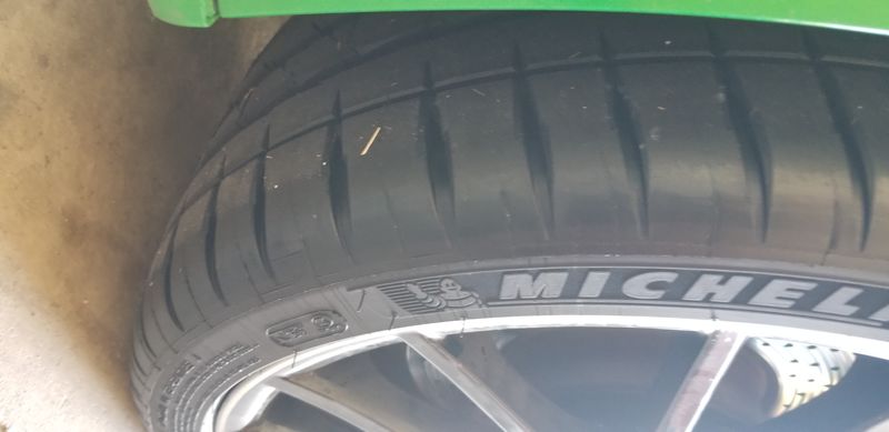

Obviously went w/ the 4S. Figured it would be the last time I could afford them. Was leaning Conti but thought for $120 I could have the Mich. Another reason for the Mich is there's a rumor there might be a DE at Daytona later this yr and I'd love to drive there. In the past, they require you have a new set of tires and I might as well have the best if I drive there.
Final price out the door was $1570.
