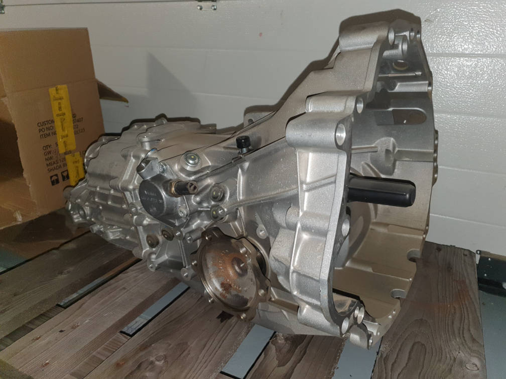

Just before the summer I bought an old 97 Boxster base model with the intention of (in due time) swapping in a Audi V8 (BBK engine is what my eye is looking for).
The biggest unknown for me is the gearbox / driveshaft side of things. So I picked up a brand new Audi 0A2 gearbox yesterday. If my info is correct this should essentially be a G87.20 box, but with the tall diesel gearing.
Attachment 23539
I plan to drop the gearbox from the Boxster sometime next month or November. That should tell me whether the bolts will align between engine and gearbox. The clutch doesn't worry me too much, as both are made for 240mm clutch, I am sure I can find a combination that works on both the engine and the gearbox.
Now the biggest question will be on the driveshafts. Is there any default shaft set that will fit. Or do I need either different flanges on the gearbox or different hubs on the car?
Any info would be greatly appreciated.
78F350 09-23-2023 03:49 PM
I have not done it myself, but I'm pretty sure that with that transmission you can swap the flanges from a 5-speed 986 transmission. The flanges on that Audi transmission are spaced wider and take larger bolts than the '97 axles.
Check this if you haven't already seen it: http://986forum.com/forums/diy-project-guides/56663-audi-transmission-swap-diy-thread.html
It should bolt to the engine. Have you looked at shift linkage and mounts? I'm not sure about those. It might have the same attachment points.

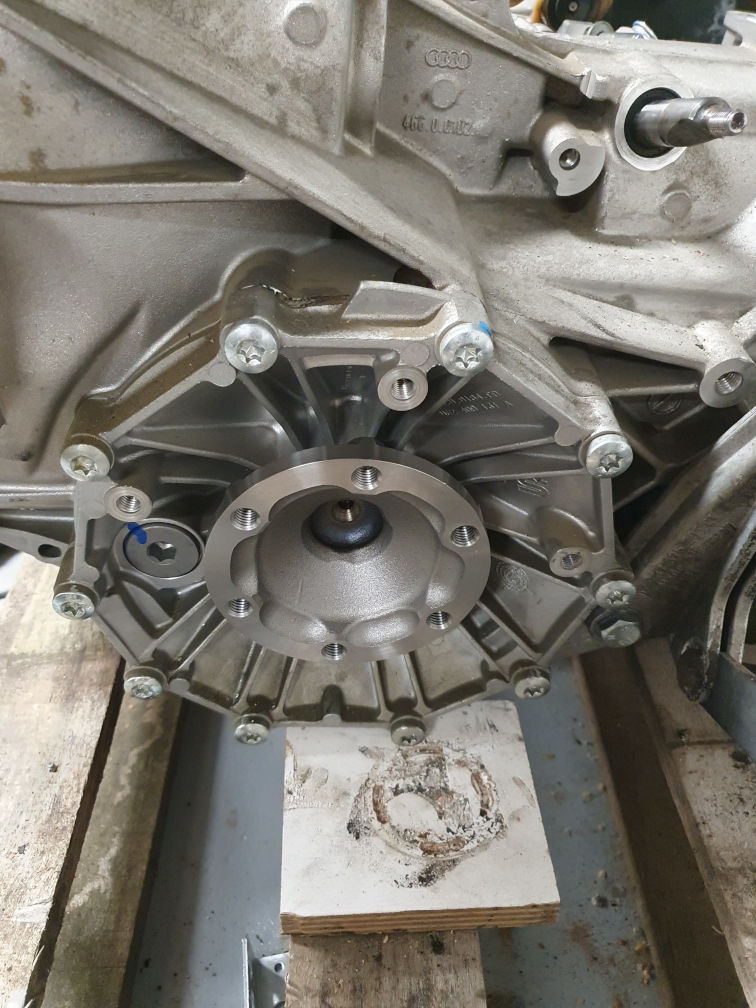

Slowly gathering more parts;
- 987 Transmission mounts used
- New Sachs clutch for the base 986
- 987 shifter + cables
- New 987 driveshaft flanges, see below;
Attachment 23562
Also I have some parts to fix the current 2.5 engine. So will complete that first, than sort out the shift linkage of the 0A2 and mount it.
One question on the shift linkage; It seems the 987 uses a stiff spring to prevent accidental engagement of reverse. This spring must be in the transmission and it should be somewhere on the selector shaft. Can anyone confirm that it is the G87.20/21 specific selector shaft that is responsible? Stock Audi transmission doesn't have this, reverse lockout is in the shifter instead.
Just wondering whether it would make sense to insert a new selector shaft or just add the reverse spring in the shift mechanism.
Marc_986 10-15-2024 11:45 AM
The gearbox swap is progressing well, time to share some info back to the community.
I sourced a Porsche G87/21 transmission and this one is now in the car, behind the stock 2.5L. This box is indeed very similar to the Audi 0A2. There seem to be two difference (other than the gear ratios, obviously);
- Porsche selector shaft contains the ramp for added resistance in reverse engagement.
- The tail housing of the box is slightly different. Porsche unit has mounting holes for that steel weight and for the exhaust. The Audi has neither.
I'll work out which gearbox is going to be best for the V8 and mount that (+ swap what is needed across).
Other things to note:
- The gearbox is in the original 987 mounts
- Stock (new) 986 clutch.
- Using 987 shift cables (much shorter than 986 ones) and shifter (986 shifter was worn)
- OEM muffler doesn't fit behind the box. Found a used sausage muffler which just clears.
- Using 987 driveshafts and 987 wheel carriers. Requires 987 shocks.
- The 986 parking brake cable needs to be used, the 987 e-brake mechanism inside the car differs.
- I've used 987 brake discs and made brackets to hold the brakeline. Brake hose is routed differently in 987 due to the exhaust in the wheel well.
So while pulling it all apart I replaced the suspension arms, top mounts and springs (M030). Basically the back of the car is refreshed now and should be good for some time. Main things left are to create a bracket to hold the muffler and solve the ABS speed sensor difference.
