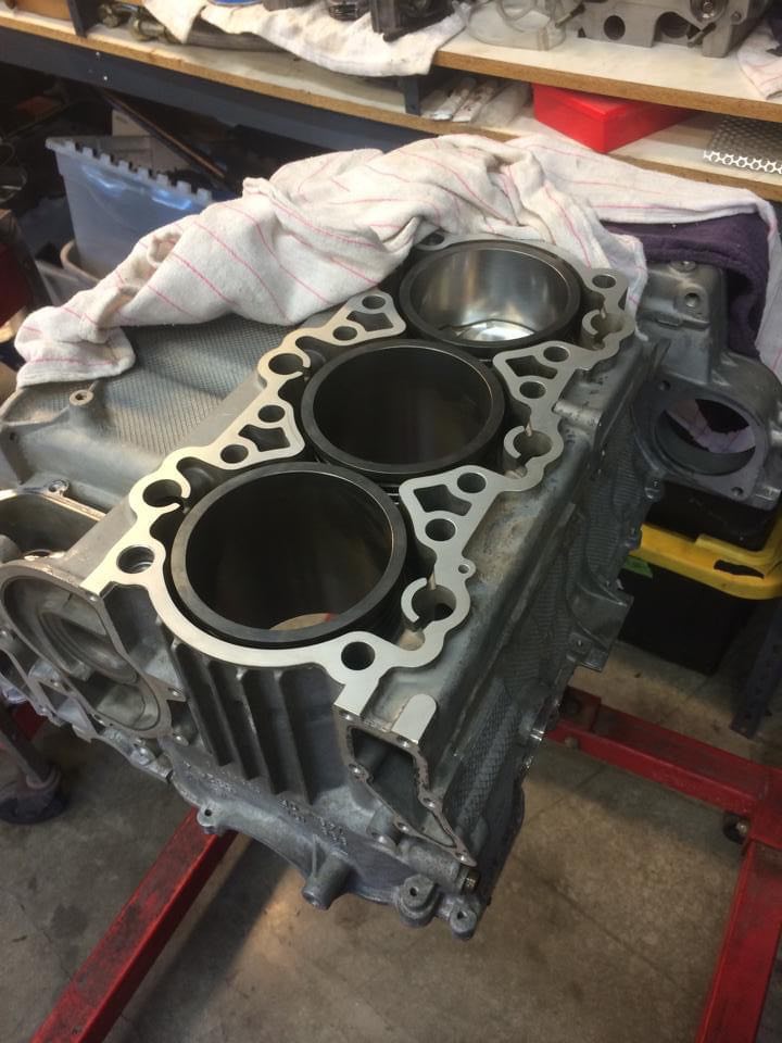

Graduated, started making money, started doing stupid things to it. Some aesthetic stuff here and there. Took a 3.2 out of a Boxster S, re-sleeved it to 3.8, and stuck it in my car around 2016.
The engine has been a blast to drive with. I've put about 80k miles on it since the swap back in 2016. I've since gone on to own some other fun cars and projects. Changed professions a few times. Bought a house. Got married.

The block was from a 3.2S that has been re-sleeved to 3.8L

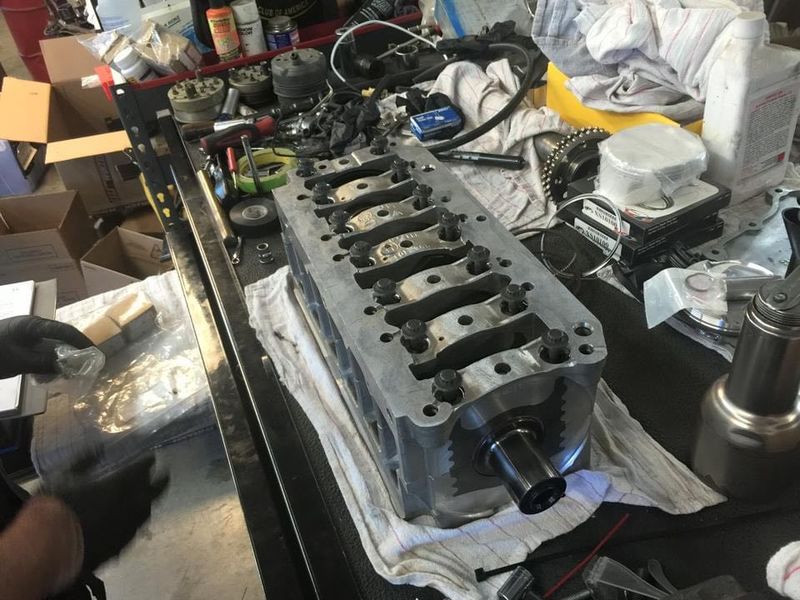

The heads are modified 3.4 996 heads
Compression is 11:1 with 5 cut angle pistons

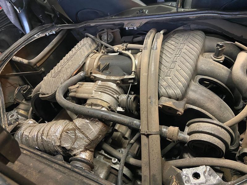

The intake manifold and throttle body is unmodified from the 2.5L (!!)
The intake tube is an EVOMS aftermarket intake
The headers are from Fabspeed
Running a bench flash on the older DME.
Finding someone who will tune this has been a nightmare, but I think I may have a lead.
My first order of business is to upgrade the intake manifold and throttle body, probably from a 3.4 996, and then re-tune.

full intake assembly from a 1999 3.4 and you can keep your cable throttle. may have some interference with the chassis due to intake height, but massaging and perhaps small spacers on the engine mount to lower the motor should set you up. can also get more clearance from a 987 engine cover.
since you have 3.4 heads already no need to drill/tap for the intake, but i think you'll need to run the 3.4 fuel rails as well (mounting is different) which will require tie-in to your existing fuel system.
think about maf and air filter as well, which will drive what you need for a tune. ditto injectors - later 996 runs larger units. a lots of threads here about 987 airbox, maf tube diameter, etc.
make sure your fabspeed headers are not for a 2.5, otherwise not doing yourself any favours.
you can boost these things, just don't get crazy unless you want to drop the compression. perhaps see what you think about your 3.8 once you fix the breathing issues before boosting. although 2.5 intake would actually be better in a boosted application ...
