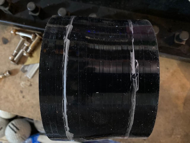

I mocked up the intake and the silicone boots fit perfectly. They were 3.75 to 3.5 reducers. They were 3” long so I had to trim 3/4” from each side to make them close to the original boot size. I’ll try to get pics up later.

Progress Report: Spent a couple of hours yesterday in the garage. I was able to rehab the 2.5 harness as it was oil soaked from the previous vehicle. I wiped down all the exposed wires with brakeclean and replaces the cloth electrical tape with the same purchased on Amazon along with some mesh wire loom for about $30. All looks pretty clean now. I mocked up the upper intake using the throttle body and runner from the 2.5 and the back runner from the 2.7. For the TB runner I used some silicone adapters bought for $9 each and trimmed them down. I removed the vac valve from the rear runner and am looking for something to plug the holes with. Lastly I wired the engine with the 2.5l harness. A couple of problems I ran into were the O2 connectors are different from 99 to 02 and I have the stock 02 manifolds on still. Also there were only 2 O2 connectors on the 2.5 harness I will have to take a closer look at the 99 exhaust (it is in a separate location) this is easily fixed I just have to decide which exhaust to go with. The MAF connector is also different. Not sure if I have the MAF from the 99 or not?? I know that this thread may not be very interesting to many as I am swapping the 2nd least desirable engine for the least desirable engine but my reason for doing so is simple. I have a very clean and good running 99 that I don't want to do anything to this satisfies my itch to tinker with the Boxster plus the cost to this point is very low (probably have 1/3 of the low book invested via some good luck and a little negotiation. Thanks for following.http://986forum.com/forums/uploads02...1612099373.jpg
http://986forum.com/forums/uploads02...1612099395.jpg
http://986forum.com/forums/uploads02...1612099766.jpg
http://986forum.com/forums/uploads02...1612099777.jpg
http://986forum.com/forums/uploads02...1612099792.jpg
http://986forum.com/forums/uploads02...1612099817.jpg
