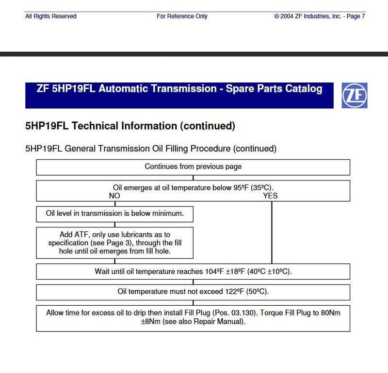

I bought a 97 boxster tiptronic, with no issues at all. Scanned, everything was ok. Then i started to read about the model, and i was concerned about de IMS, so i replaced it with parts from Pelican. I took the oportunity to drain the torque converter and replace fluid (filters gaskets also) on the tiptronic transmission. Then my mechanic built everything, and the lights on the gear and lever on the panel were blinking. Also cant use "manual mode" nor the 5th gear. He checked everything, but the problem are still there.
Searched on the interenet, seems to be something called "limited driving programme" where the transmision limits itself in event of a failure. On the internet also i found most of time is related with transmision servicing, but i changed all fluid (torque converter including).
I used the recomended ATF by manual (pentosin) and changed filter, gaskets from ZF (the transmission manufacturer).
