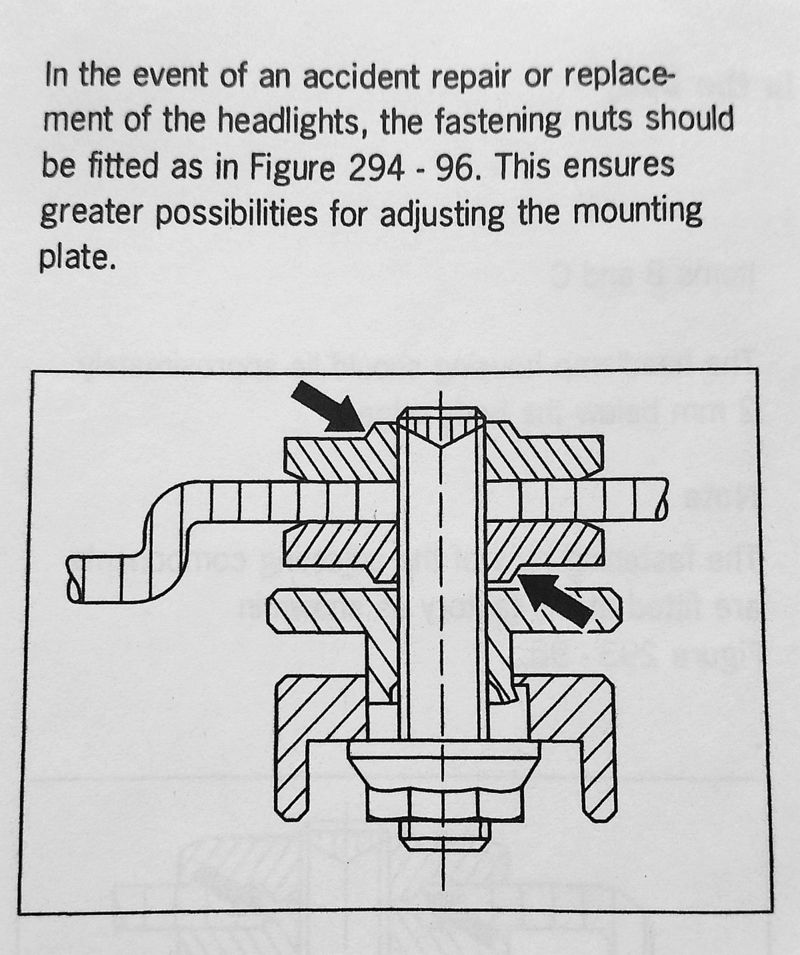

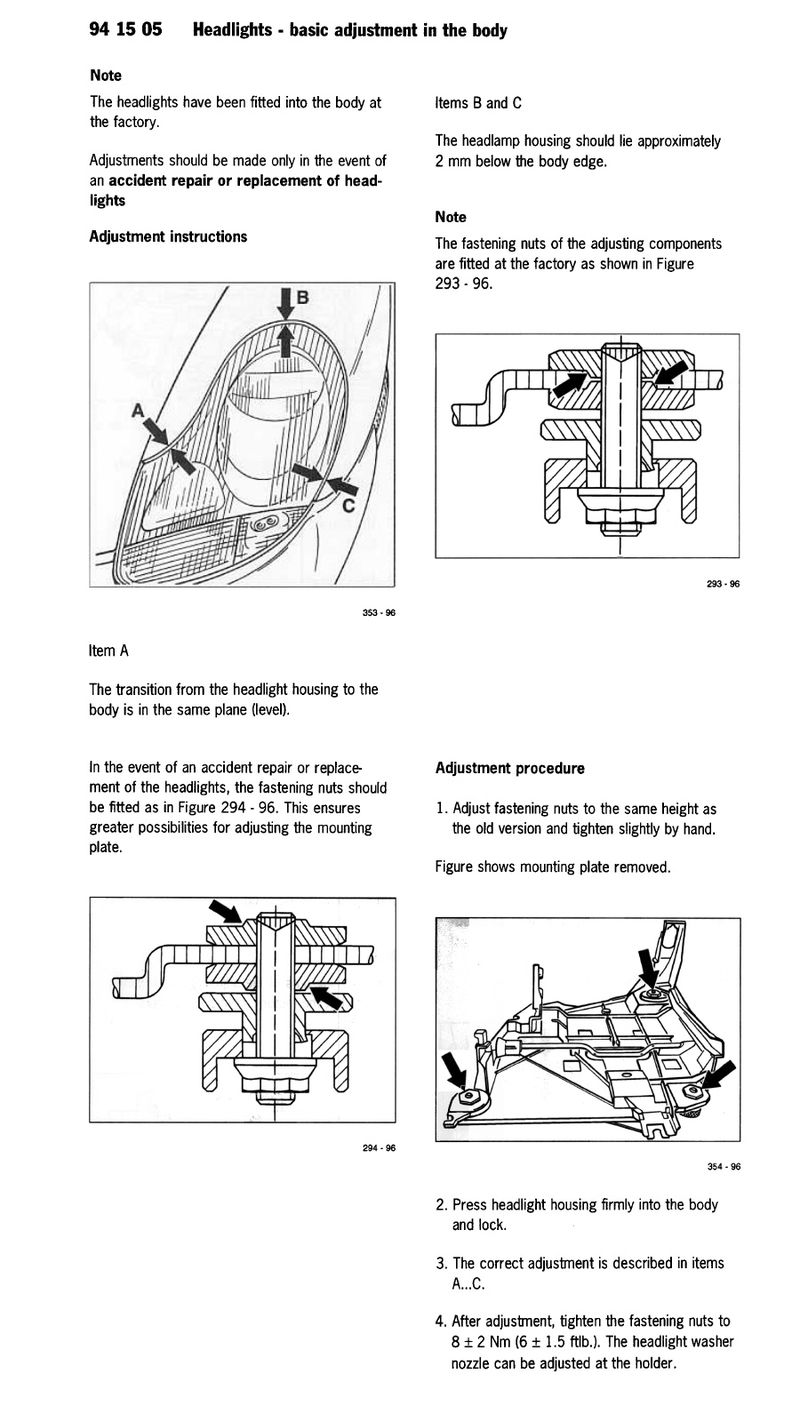

Here's some instructions about the headlight mount I posted a while back...
Hope it helps.

See attachment.
