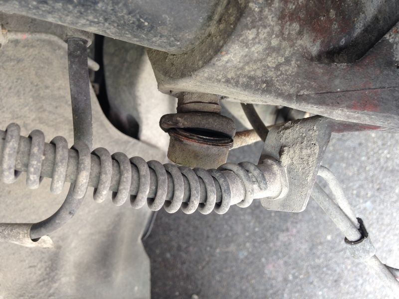

Your in the right direction.Get the front end done first. All of the squeeky will be gone. Not that big of a hit on the wallet.Yes if you have a hotrod background like me these cats have a different name for some parts. But we get it.http://986forum.com/forums/uploads02...1473344358.jpg
Exibit A
