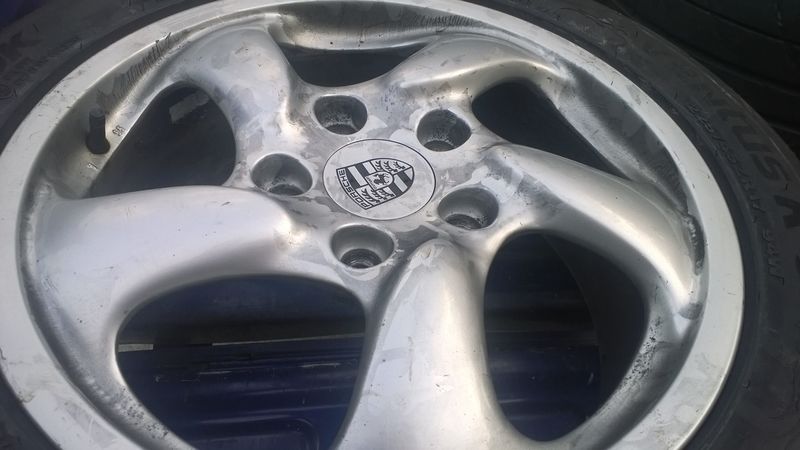

Not really, sometimes they will squeal a very little bit but it is minor and usually getting on it a little will solve it. dust.... since I mostly drive on the track, my wheels usually look like this:
http://986forum.com/forums/uploads02...1463165736.jpg
Then I wash them and they stay pretty clean until the next time...
