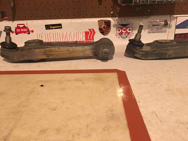

The 987 coffin arm is on the left, 986 on the right. No way the 987 coffin arm is going into a 986 trailing arm fork. Hey Gilles, how about measuring the eye-to-eye centers on your 987 trailing arm?
Unfortunately I don't have a new front trailing arm, and my car is parked on a neighbor house because tomorrow I have to do work on my wife's V70 (also front suspension..) but I will try to measure the front trailing without removing it on Sunday, I will let you know.
Regards, Gilles
