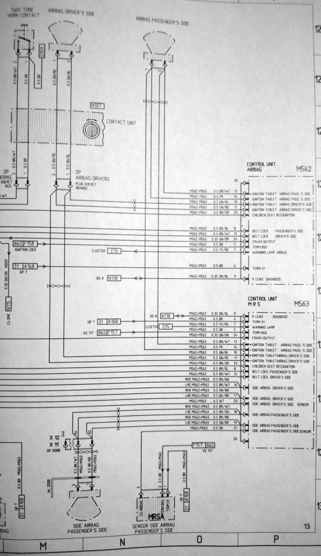

Got another replica in for air suspension, new rims, stereo and alarm install. Customer wants me to get the airbags working. Problem is that its missing the side airbags on the door panels. The steering wheel airbag and passenger airbag are there since it's using the oem dash. The door panels are completely different. Can I bypass the side airbags by turning them off? From everthing I read is that if you have a fault none of the airbags will work.
