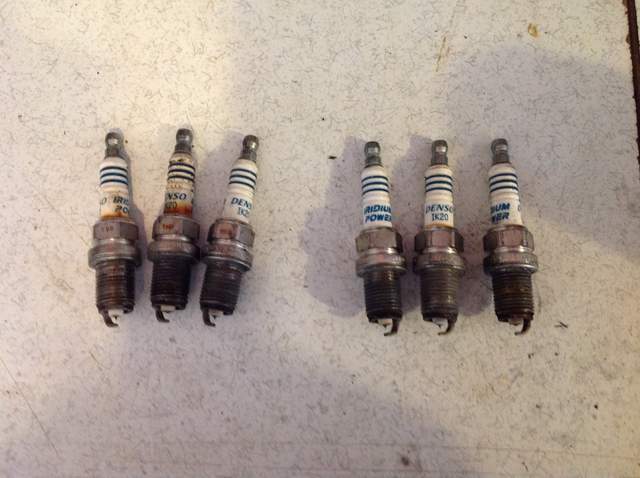

I've used the Denso iridium plugs and was not happy with them. After 20k I had to replace one do to the tip being burned so bad I got a misfire CEL. At 30k, I changed them all for Bosch, and two more of the tips were going.
Bosch have always looked good when I changed them, and I wondered if they could have gone a lot longer.
