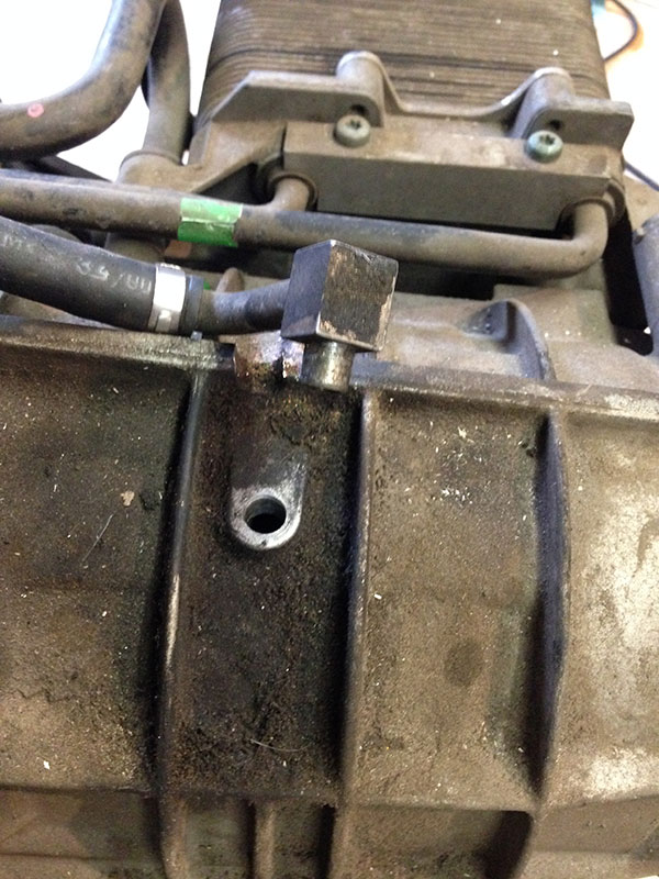

Unsure about this hose on tiptronic
I'm not sure exactly what this is and is this fitting only pressure fitted into the hole? Seems odd.

its a vent.
mine is mounted a little different.
if you pull the cap off (don't do it though) there is a little weight in there.

Mine's a 2001 S
The fitting just friction fits in the hole. I dropped by my indy today.

yep just a interference fit...
Mine is a older model and the vent tip is just a mere inch away from the plug in.

A bit surprising, considering the accumulation of gunk around the hole which suggests that it has been blowing ATF out for a while.

Nah im sure it was just seepage, not enough to even measure any loss.
